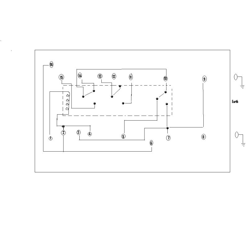

Hi,
sorry for the delayed reply to this post, I have been very busy of late. Anyway on to the valve, I think I have solved the problem (thanks for the assistance):
The original valve that I replaced was a mid position valve, but having analysed the circuit (please see diagram) this is not a Y plan and so it should have been a diverter valve. I have found that by detaching the orange wire (and covering the end) the boiler and pump still come on when calling for Central heating only; I think this in itself proves it is not a Y-plan system - the pump and boiler should be energised by the orange lead in CH only position (but fed in the HW only position) and the grey lead should be on. Since I also (wrongly) replaced the Mid position valve with another I have effectively made it behave as a diverter by joining the white and grey lead and removing the orange lead from the circuit. This works perfectly as a Hot water priority system which, being in a flat, is fine from a practical point of view.
As you can see from the diagram, there is a relay in the circuit (which apparently is quite an old design)
Using a voltmeter I have determined that 10 is HW on; 11 is HW off.
9 is the feed to the switch.
A continuity test confirmed that the Switch had been wired correctly
16 = 2 = 6 (Neutral)
1 is from the programmer and energises the relay.
Now if Hot water is called for and CH is off (not called for) 10 energises 14
If HW is called for and CH is on the relay is energised and the switch moves from 14 to 15 so 10 energises 15.
If Hot water is satisfied 10 will have a small induced voltage, but 11 will be energised. This will energise 13 if and only if the switch has moved down which will only happen if the relay is on when CH is called for. Otherwise 11 will be disconnected.
I have therefore attached white and grey to 13 and removed the orange lead (which was originally on 14). This works correctly and the boiler and pump still come on when CH only is called for.
For completeness I also tested the behaviour of the 3 port valve using the tests you sent me (thank you - these proved the 3 port valve worked correctly - a pity I did not buy a diverter, though!)
Please note, there are also other terminals 17, 18, 19 and 20 which Satchwell did not display on the internal wiring diagram, but using the voltmeter I have confirmed that these correspond to the Programmer.
Thank you very much for your help. I can now control HW and CH independently as a HW priority system (W - plan I think)
Many Thanks.
The giveaway would have been how many wires your old valve had if three, its W Plan. If five, its a Y Plan.
Anyhow, it would be better to persevre and change to a Y Plan, mid-position valve. Only a few wiring changes needed, and it means that you don't lose the heating when the cylinder is heating up.
Hi,
Thanks for the reply. The original valve did actually have 5 wires which led to the confusion. The previous installer must have attempted to put in a Mid-position valve when it should have been a diverter (which as you say has 3 leads). For example, with the old valve CH was wired to 15 which becomes disconnected when CH is called for (clearly wrong). So it was not obvious (if you assume the previous installation was right), hence the detailed analysis :) .
Thanks.
The acid test though, is if your rads went cool when the hw was on. If yes, then it was wired as W Plan.
True! In hind sight this would have been easier than painstakingly working out what each terminal corresponds to (although it did mean I could work out that the white and grey needed to be attached to 13). Am I right in saying that having a relay box is quite an old design. Presumably, if I wanted to have a Y plan (being a small property it is not really necessary) it would be better to start from scratch as in the wiring diagram a previous member sent, there was no relay in the circuit. A project for another time, perhaps.
If its a small property, you might be happy with what you have.
Yes, it would be best to start the wiring centre connections from scratch rather than trying to rehash things.
If you sat down with the Sundial Y Plan wiring diagram, and took your time, it wouldn't be difficult.
