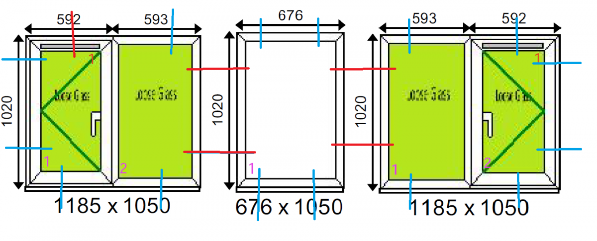

Hi Guys,
I have a big window (see picture) consisting of three separate units.
When I will be installing it, do I need to attach the middle panel to the side windows (red lines)? If I do need to do this, what is a the common way of doing this, bolting/screwing?
Or just screwing all units into the walls (blue lines) will be enough and there is no need connecting the units between each other?
Thanks for your help
window-png.81930
Should be using a coupler AFAIK, supplied by the window supplier. One of the experts will answer no doubt .......
Ideally yes use a coupler to join them, run a bead of silicone down each side and thick enough to touch the window and coupler then screw through the window into the centre window/panel using bay pole screws
Thanks guys,
Yes it does include the couplers. Will use the bay pols screws
