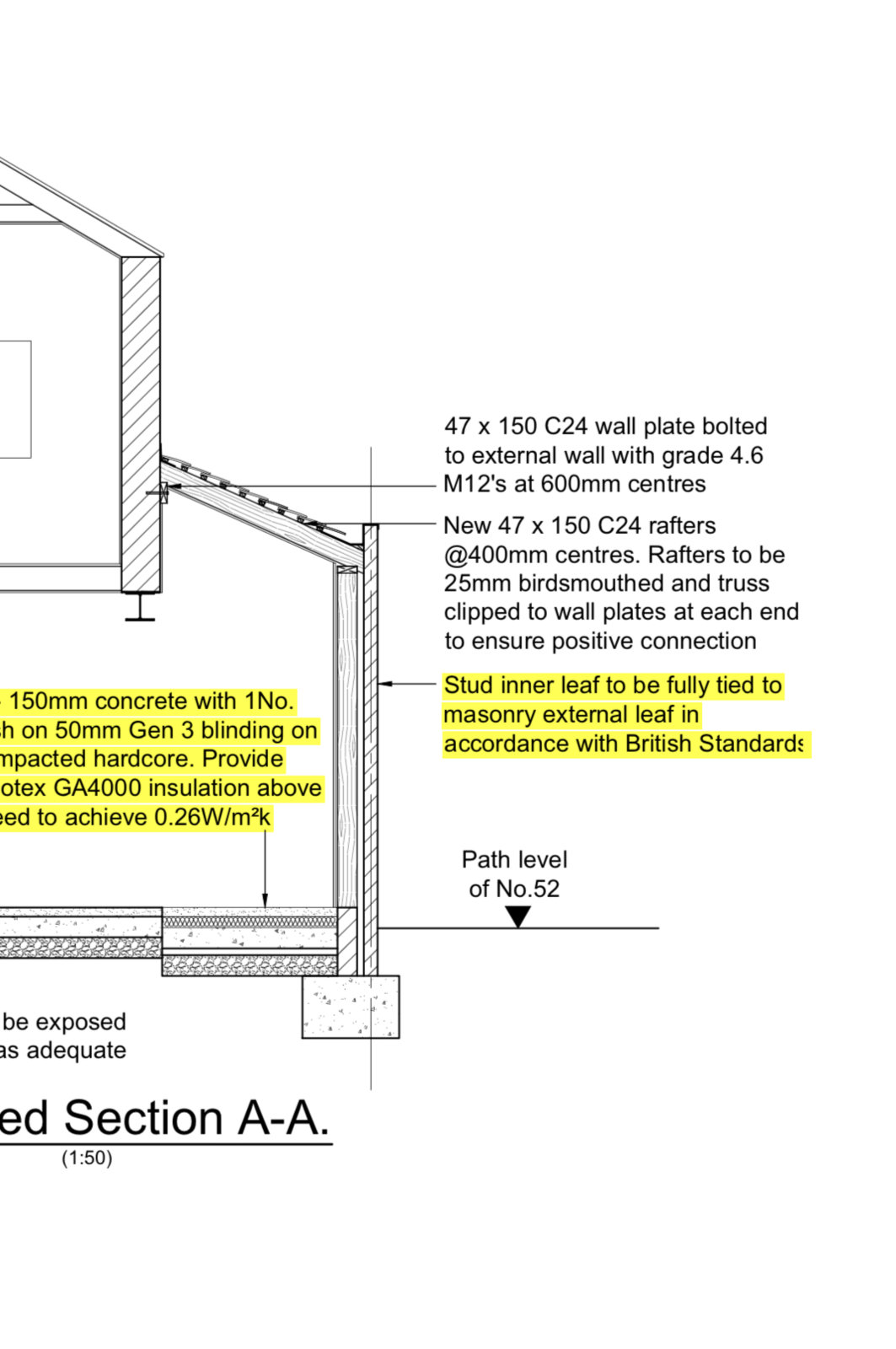

I’m going to be having a extension commenced shortly but in a bid to save some money, I will be completing the internal timber stud to complete the external single skin block wall.
Now these need to be tied together, so does this mean the timber stud wall needs to be built first or are there ties you can use after the block has been built.
Below is a diagram.
