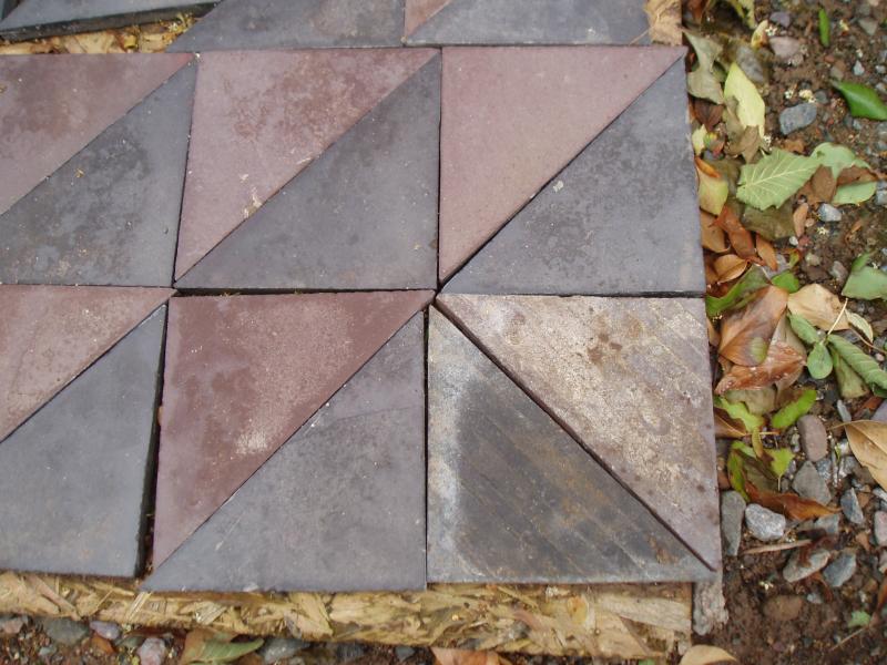

Hi, I'm going to tile an outside porch with reclaimed victorian tiles. Can someone please recommend an adhesive for the job. Presumably the adhesive would have to be waterproof. Also can I use the adhesive as grout as well. The area is very small 40 x 160cm.
Many thanks.
what are the tiles made of?
does the porch have any cover at all or is it totally in the open?
Hi Jefoss
Thanks for replying. I'm unsure what the tiles are made of. They look a bit like quarry tiles (see picture).
The porch has a roof over it, but the sides are open so rain could blow in on a blustery day.
Thanks.
Derek
get a porcelain adhesive and go ahead, its not like its goona be under water all the time, no probs at all.
