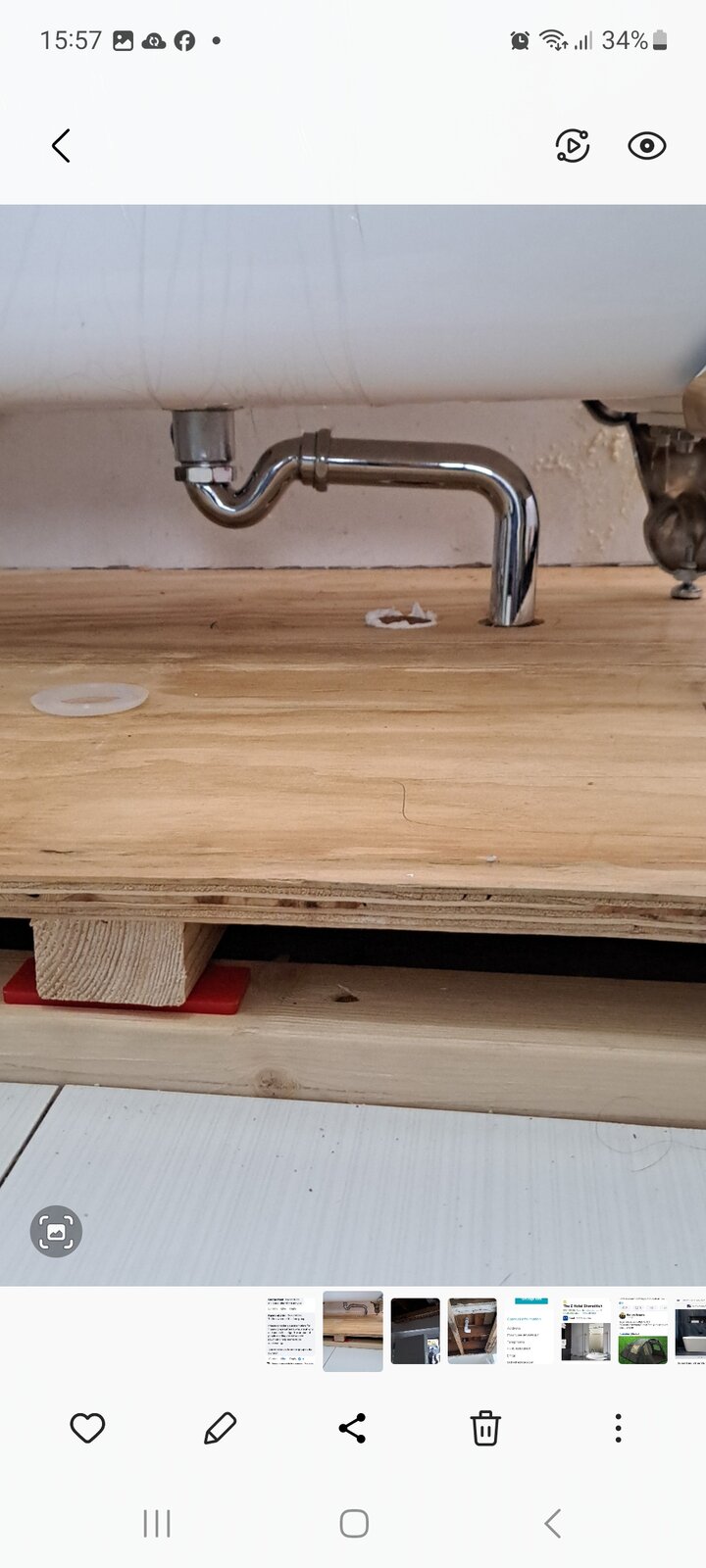

How would you best tile around this waste ?

I am guessing that you are going to have to remove the bath to tile in the first place. Can you not remove the waste and use a hole cutter?
Yes bath can be removed and a hole cutter for tile but the crome pipe is a bend in one.
Would I be able to slide tile over crome and around the bend ?
Possibly but that depends on the size of the tile and sounds really difficult. Additionally, you will have to cut a hole large enough to accommodate the nut.
Cut waste pipe at vertical section out of floor and add new elbow section allowing tile to drop over pipe.
