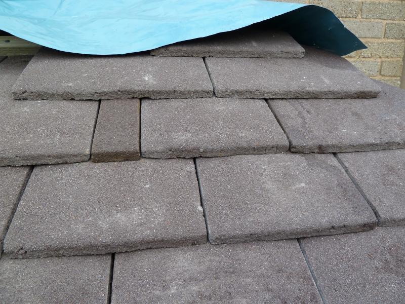

Thanks for the information, so far.
As I am getting towards the top of the roof, I am finding it difficult to keep the bond:
(1) Can I put in a tile slip, like the one shown in the photo? The side lap of the tiles is 55mm and therefore does not need a lead soaker .
(2) Should I adjust the bond so that the layout is shifted along a bit and not in line with the lower courses ?
(3) Should I put tile ‘slips’ at the end of each course? As they would not be ‘hanging’ from a batten would they need fixing in place with mortar underneath and then held by the hip tile mortar? I am a bit concerned about this as the overlap of the baby hips is not that great- would the tile slips, slip?
Hopefully, you are able to access a picture.
Any thoughts?

Why are you having trouble with the bond?
Is it a hip roof?
If so, you tile away from the hips and cut up the middle.

You run up the hips first.
First thing to do is set out the eaves course in relation to the first hip as these sit below the first hip course. It is important that the bond is worked out and you end up with a pointed eaves cut at the hip.
You then mortar bed and fix the fist hip tile centrally on the hip using the adjacent tiles as a height guide. Run say 3 tiles out from the hip.
Repeat this all the way up the hip. You may need to cut the tiles against the hip depending on how good the hip tiles sit against the pitch of your roof.
The hip tiles will bond your tiles.
Tile from the hip into the middle. We often bed the ridge as we tile along then lay the last ridge and tile DOWN from the ridge. Tricky at first but easy once you have done one. You need a supply of tile'n' halfs for this part of the job.
This method avoids having to clamber over the tiles.
Don't forget lead soakers at abutments.
You then fix your stepped cover flashing once the tiles are laid.
You then mortar bed and fix the fist hip tile centrally on the hip.
Just to add: Don't be tempted into shoving the hip tile either left or right of center just to suit the tiles either side, because your hip will end up meandering like a scenic railway.
If needs be CUT THE TILES.
