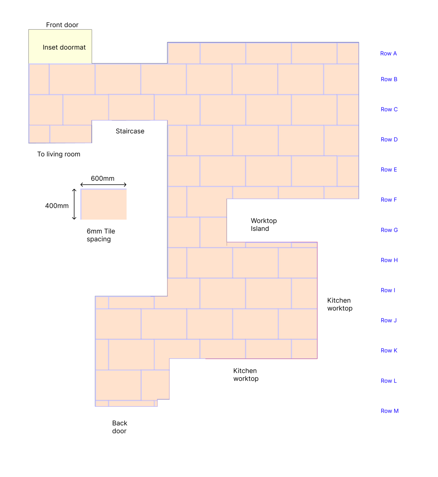

First time setting out tiles, so I've drawn out a bit of a plan.
Fairly happy with the horizontal layout. The backdoor has a really thin strip just infront of it, but it's not easy to avoid. I'm wondering whether to put an inset doormat there since I'm putting one by the front door due to low clearance.
Tiles are 600mm by 400mm and I'm planning on using 6mm tile spacing.
Any thoughts welcome. Thanks

Personally I prefer thinner spaces between tiles, but it's my personal taste.
Plan looks good. Hopefully walls and cabinets are square.
I think that you get a better result if you move the tiles towards the front door by a half tile. I think that this will get rid of the thin strips on rows G, I and M.
