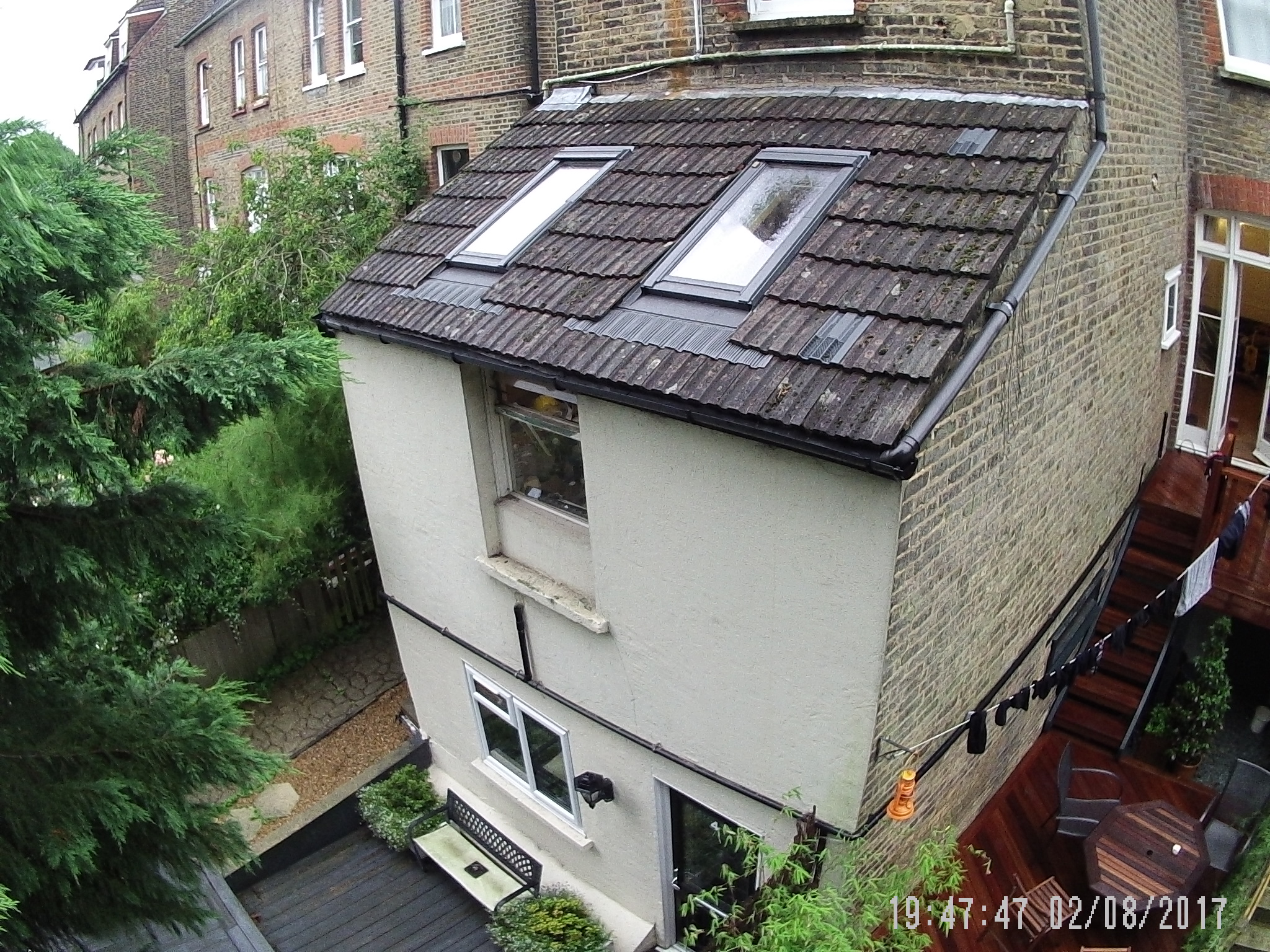

Here is that roof I was talking about with the tiny slithers:

Here is the finished roof:
You might not be able to see, but we didn't end up with tiny slithers because we fudged the middle section of tiles. Over the course of 5 rows of tiles we were able to "lose" half a tile . But basically the bottom row is squashed together and top row spread out. Not ideal, but given that no-one we spoke to was willing to offer a solution, this worked, and with the really heavy downpours we've had, there hasn't been a single leak. The ceiling is exposed so we're certain about that. Plus it was my mate's idea, and it's his roof.

set the windows to suit the tiles. You only needed maybe 30mm one way and you would have no cut. the other could have been moved a tad to make things look symmetrical I expect.
if things are really really desperate it is possible to jump the bond by half a tile, it is still weather proof.
Maybe this is what you did between the two windows?
of course you would need to cut the verge .. needs must sometimes.

I'm interested to know about what you refer to as jumping the bond by half a tile between the 2 windows. I'm staring at your photo and I can't get my head around what you mean. If one of you guys can explain in more Noddy terms it would satisfy my curiosity.
The cuts butt the upstand not go over it.. I think thats what you are asking As for bashing down..no never there is no need
23vc Jump the bond Noddy!
So you can slightly adjust the overlap between interlocking tiles next to each other? I can't see how that's possible as they only lock together in one place?
Also doesn't that mean that the velux's aren't square to the tile line for that to be needed?
(Sorry not trying to hijack the thread, just genuinely interested as I've got to do something similar on mine eventually)
Redland 49s and similar tiles are usually laid with a straight bond, but can be laid with a staggered bond.
Therefore between windows as in above pictures you can move the tiles across half bond and still marry in above and below.
