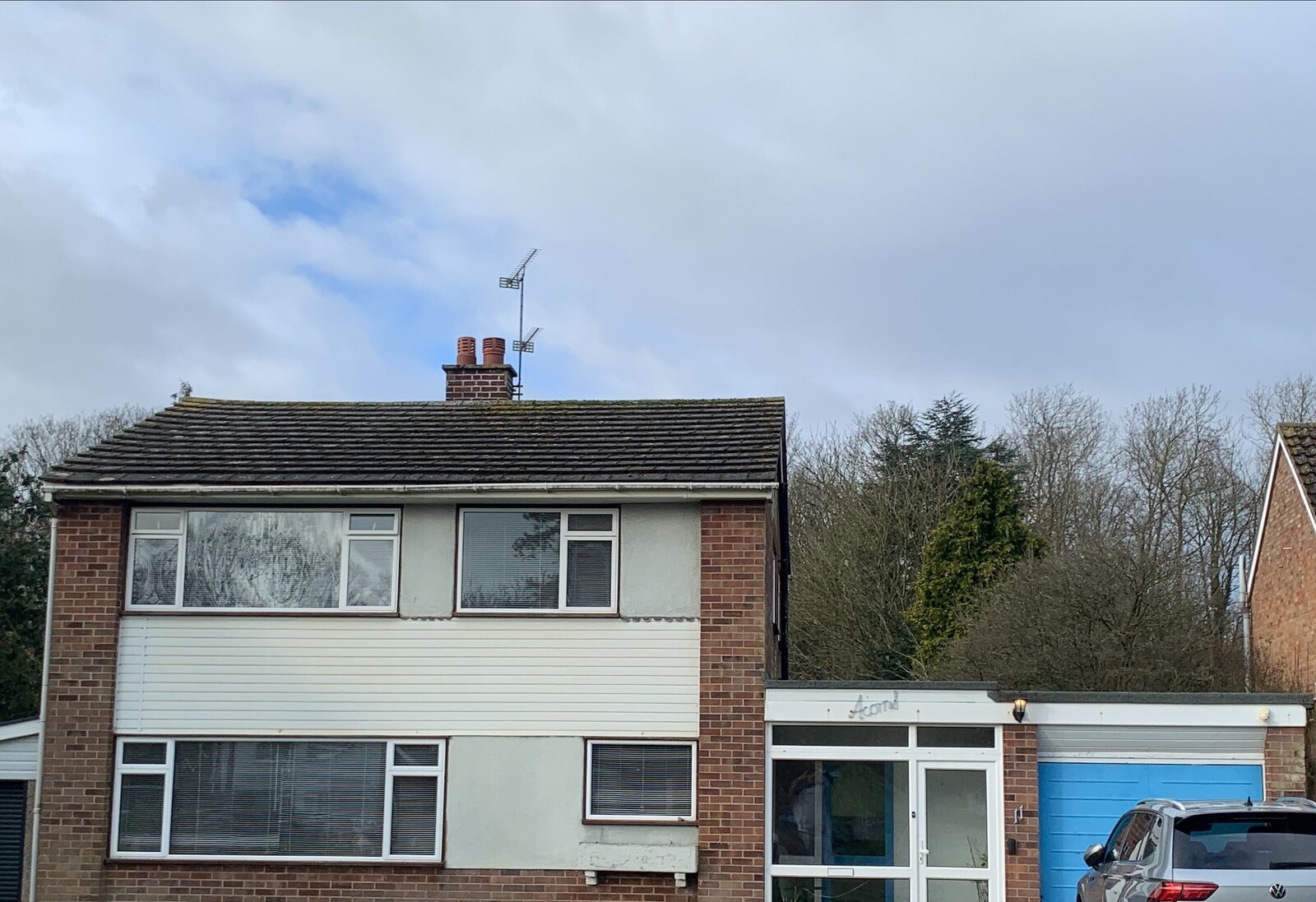

We are soon about to start a big project ive uploaded some photos of now and also an image from the Architect. Currently we have loads to do before construction can begin were moving Gas and Electric supplies its a nightmare. But we have now been talking about the roof material now do we go with Reclaimed tiles to match the same or do we replace with new tiles let me know your thoughts on this? Does the current roof look shot? Inside the loft the felt it was fine currently but obviously with the new extensions etc there's a lot of work going to be done up on the roof joining the old to new
Looking at these tiles from down here Ive been trying to match them and seem to have found them close to a concrete tile from Marley?

Given the age and style it could be Marleys . they quite often have their name stamped large on the back
