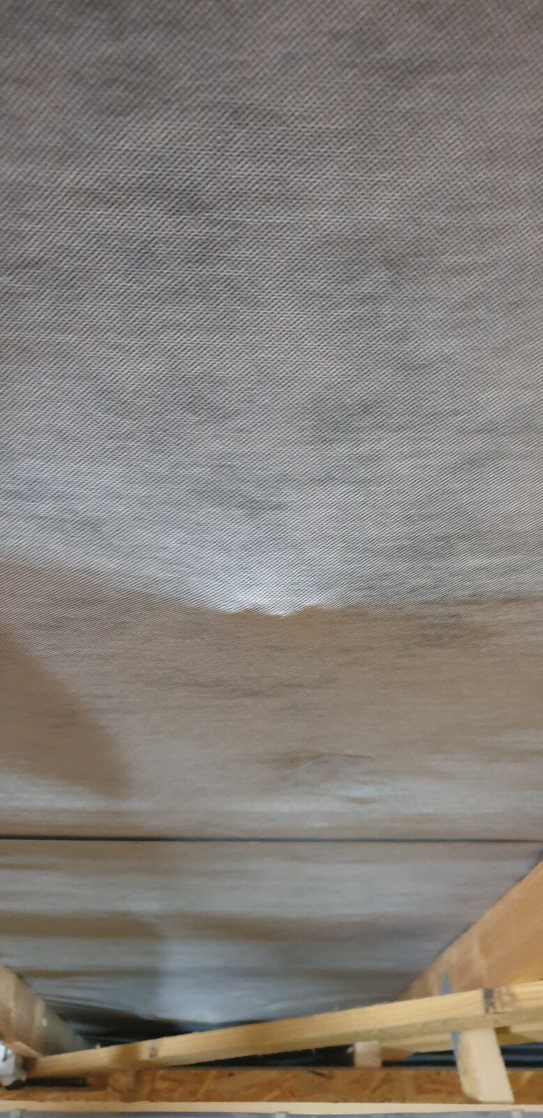

Hi all,
I have had a new roof fitted on my house and they roofers have left quite a bit of tile offcuts between the felt and the tiles.
I have attached a photo.
What should / can I do?
Any help much appreciated.
Kind regards,
Mark.

I could try and get him back to fix it but it may be more hassle than it's worth so at the moment I am thinking I should just cut the felt and repair with some form of tape?

But if I leave it then surely it will eventually just wear a hole in the felt anyway so as the loft is pretty much empty now I thought it would be better to fix it now?
Plus if I leave it in then it may work it's way down and then get stuck at the bottom where I cannot access from inside the loft.
I was going to cut a slit in the felt and then use flashing tape to fix it?
What is the pic actually showing in relation to the issue?
In the middle about 2/3 of the way down the pic it shows the felt being stretched by the debris which is jammed between the underside of the tile and the felt.
OR ladder and remove a tile and fish it out from the eaves?
I suppose that could be an option. May be a bit difficult to find the right tile to lift.
I have decided that I will remove the debris from the outside by removing / lifting tiles as @kp00110 suggested.
