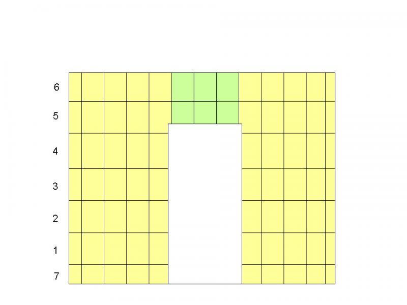

How do you tile a wall floor to ceiling if there is a door? I can think of 2 options
1) Tile the wall on one side of the door, the top rows would go above the door to the other end of the wall. Then tile the wall on the other side of the door upside down, i.e. starting from the upermost row and going down, securing each tile with gaffer tape. Perhaps will have to wait the adhesive of the top row to set off before securing to it.
2) Nailing a horizontal baton across the whole wall, including door opening. Sticking the first row of tiles on one side of the door, then measure as precisely as possible the width of the tiles and spacers that can be accommodated in the door opening, marking this on the baton and tiling the other side starting from the mark. Then nail vertical batons on both sides to give me datum lines, tile to the top. Tile above the door.
I personally like the second option but maybe you guys have some know-how. It is the first bathroom I am tiling.
i tend to try(soz attempt)your 1st option,but i tend to cut all tiles i need and work rapidily,remember you do have a bit of time before the adhesive starts to go off.if you find you cant get all the tiles on then go down as far as practical and bang a couple of pins in the wall to hold the tiles up,then carryon when gone off.hth a bit.
maybe you should just tile the bottom rows of each at the same height then it will fall into place........
a laser guide from all good larger dept stores are not expensive

gregers, I am a complete beginner, have put 21 tiles on the wall yesterday. Maybe my speed will improve in time but at the moment I can't imagine myself working rapidly :) Hence my preference of the second option.
jefoss, I have a laser guide, it is not a problem to ensure the same height on both sides of the door. But I have to be precise about the horizontal positioning of the tiles. Your post reminded me though to check that each new row of tiles is the same height on both sides, not to relay on the wooden baton and the spacers only.

Sorry, probably I didn't explain well. The door is approximately in the middle of the wall. If you imagine a continuous row of tiles near to the ceiling, there will be 11 whole tiles + 2 cut tiles at the both ends.
My idea is to do the yellow marked areas first starting with row 1 and finishing with row 7. I will nail a wooden baton horizontally on the line under row 1 from corner to corner. There is only a door frame there, no door, no architrave, so there is nothing on the way. Let say I tile left to right. After sticking the tiles left from the door, I have to start on the other side but can't just start from the door frame. I have to leave exact distance to accommodate later the tiles above the door opening.
If I don't get it right, when tiling the green area, I will have to cut the middle tiles or to have big vertical gaps between the tiles. That is where the things can go wrong. Of course, I'll do my best to avoid this.

you seem to want to do it the awkward way, as you seem to realise, one bit out and you are either cutting tiles that should be whole or spacing out tiles with 50mm spacers instead of 2mm
Well, I might go with the other option at the end, there is still time to think. As I said I am a complete beginner and this is an ambitious project for a beginner. I am going to tile the whole bathroom floor to ceiling. There are several things to take into account when deciding about the layout of the tiles - a bath (with tiled panel), vanity unit and concealed cistern toilet pan (they have a shared worktop), a window, a door.
I measured and checked very carefully several times, marked where the rows of tiles will be on the walls, made sure the datum lines are horizontal. Hopefully one or another way everything will be done properly.
