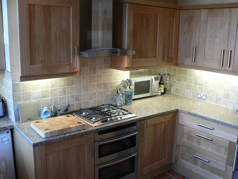

Got some 10x10 tiles today and should start tiling next weekend.
I have a curved 90cm glass chimney in the kitchen, what is the best way to tile so that it looks good?
More details needed.
With a flat extractor, you can tile striaght up to it, but i have a curved one. I dont want the tiles to go past the glass part but eed it above the bottom of the wall unit. Finish the top row flat wouldnt look good as it doesnt follow the lines of the extractor
Does this make any more sense, probably not
Without a doubt I would disconnect and take the extractor off the wall.
When tiling is complete then refit it.
Depending on what tiles you are using,if they are thin ceramics you may be able to cut curves using a scriber.if they are thicker you will need a wet saw and possibly some tile nippers,also a profiler would be handy and a grinder with a diamond blade.
http://cgi.ebay.co.uk/160mm-Contour...hash=item250269064895&_trksid=p3286.m14.l1318
I have a profiler and wet saw.
Didn't really want to cut them, was thinking of possibly laying them out, without any cuts, so like 2 tiles on the top row, 4 on the next, etc etc to create a pyramid type effect
b21playa, I wouldn't bother doing that stepped layout - you might think it'll look ok, but people will think that you can't tile and that you just left it like that rather than trying to follow the profile.
If you don't want to tile behind the extractor, then you should really try and get a tight fit against the glass.
I see you and I have the same excellent taste in BnQ units. ;)
Take the extractor off, tile and refit.
Can't believe anyone would suggest otherwise, much easier, and will look the business.
Trazor,the reason it was suggested was because in the original post b21playa said they did not want the tiles to go past the glass section of the extractor so removing it would serve no purpose :confused:
