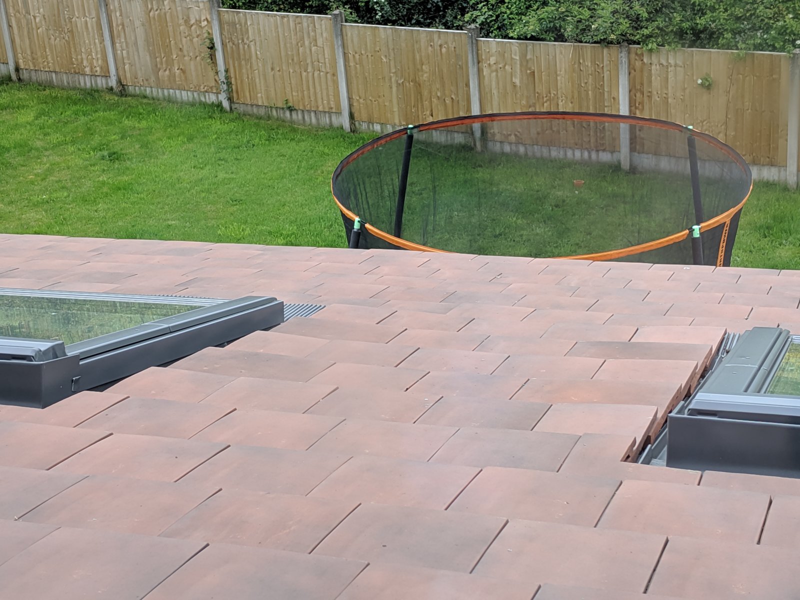

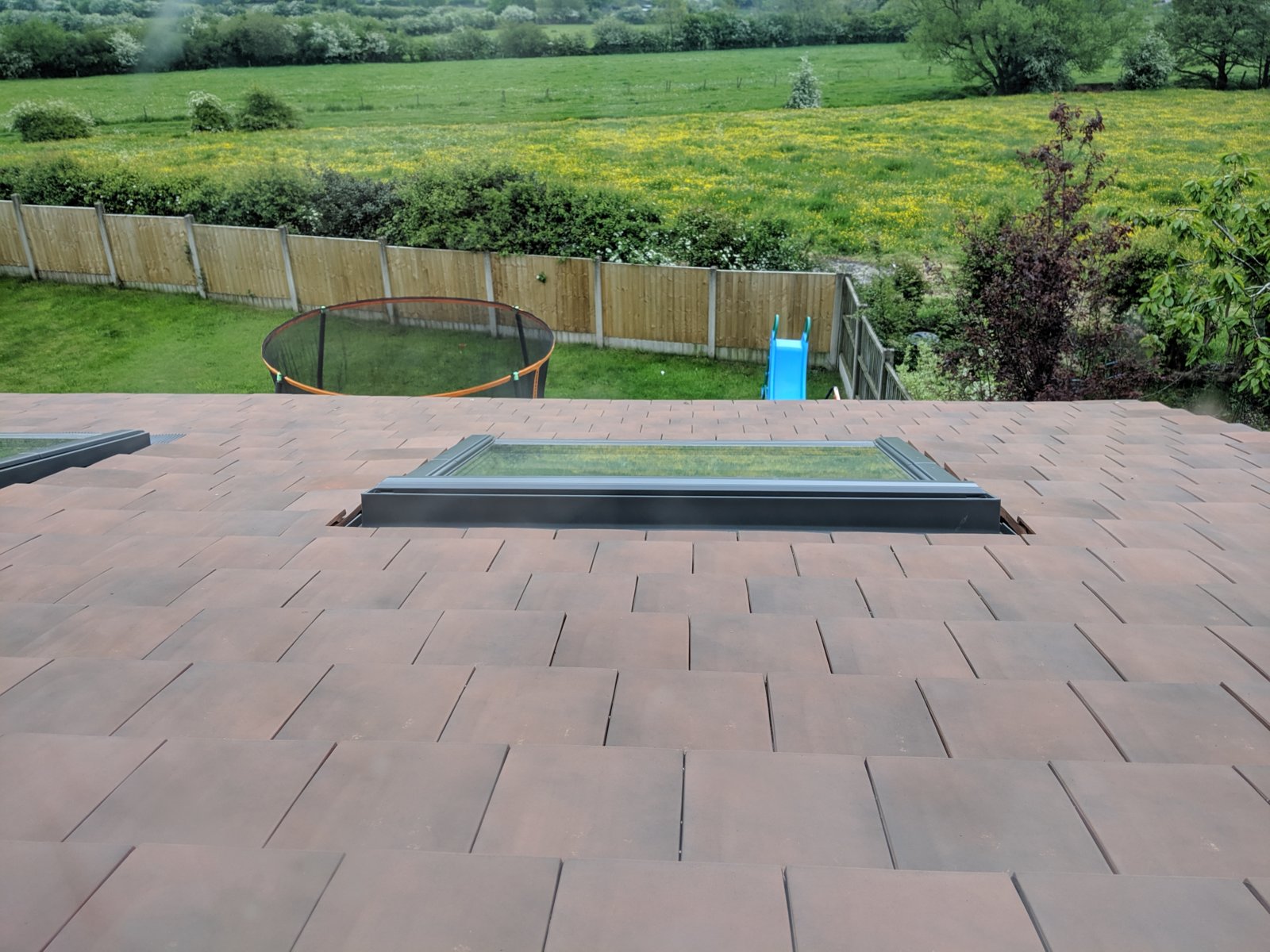

tiling around two velux windows look messy, is it done correctly?
19 May 2019
6
hi all
hope someone may be able to shed some light on this tiling around two velux windows.
it looks very messy, but am concerned that there is more to it than that.
There seem to be a lot of tiles with broken end lips/grooves (interlicking bits) .... am i picky or should i ask for those to be replaced?
The builder is saying that is how they are around velux windows and nothing can be done about it.
Should i stick to my guns and ask to make it right or are they right?
Any help would be greatly appreciated.
thank you

What's the roof pitch for starts? Velux windows go down to 15 degrees done right. Are tiles suitable for the pitch and have the right headlap if so?
Some brands do tile and halves not sure with this tile however this would have eliminated the small cuts are the Velux.
The kick up around the window is about right due to the flashing but it looks rough in places.

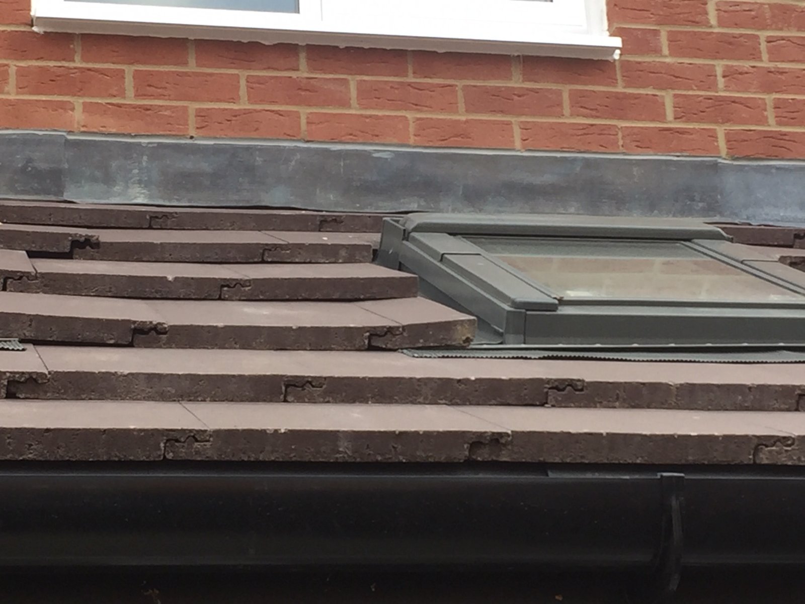

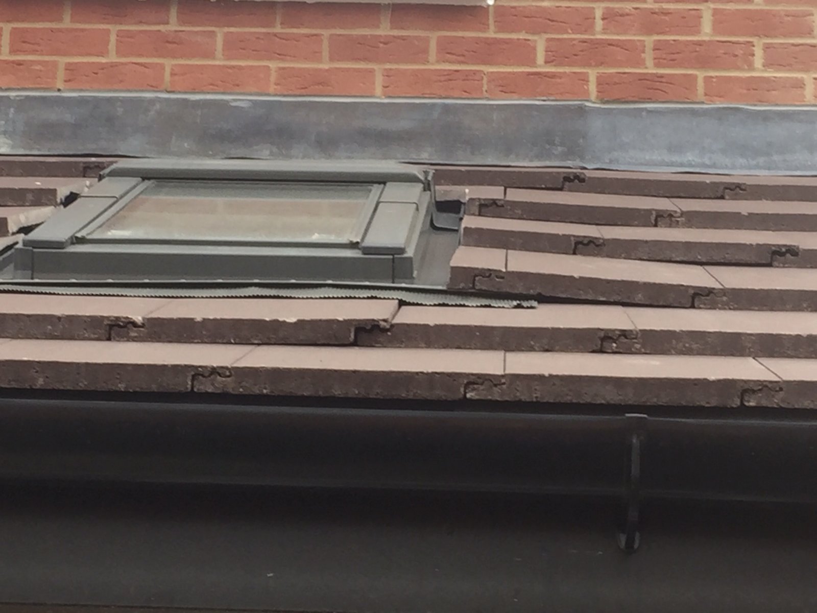

That's my extension shows the tile and halves to reduce small cuts but as I said not sure if your tile manufacturer does them.

your ones looks very tidy indeed ..... i would be happy if mine were like that.

A quick look says the tiles go down to 17.5 degrees that's got to be close. Tile and halves are available so it could have been done much neater.
Being a large developer I presume it's a new build? Looks like a price worked rush job to me with not much pride on show at all.
You don't get tile and a halve for Marley moderns. You need to cut your havles.

you reckon the best i can ask them to do is to tidy up and possibly replace those two broken ones, where you can see the interlocking end bits broken off?
is it likely to leak where the tiles are not flash on top of each other?

Your paying a premium price for a new build. Does that look like premium work? Not at all.
Create yourself a snagging list of any problems alongside this and request the developer rectify before you move in.
Doesn’t look the best, but you’ll always get the tiles kicking up as they’ve got the flashing below them. The broken interlock channels are deffo an issue tho, if they extend back beyond the front of the tile.
If it is done properly there should be no tiles lifted due to the flashing
Its a rubbish job.
The window is not positioned properly in relation to tile battens. Unfortunately there this little room to adjust battens to suit the window.
There is a cut course of tiles under the front apron flashing...Wrong!
As already mentioned there are at least two tiles with channels missing, this will leak
Possibly the foam filler has been removed , This should have been cut to the underside profile of the tile. But the i guess birds need homes too.
Tell them you want it done professionally ..its cr*p
