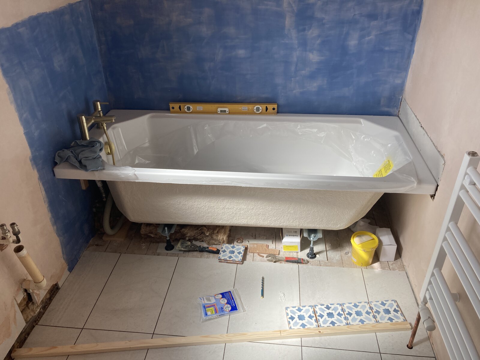

I'm currently redoing our bathroom and having completed the flooring I am now in a position to start tiling- the intention being half height splashback (to where the height of the blue paint on membrane is) all around the room.
The tiles I'm using are as per the photo, so 125mm square. I am inclined to say I want to start with a whole tile at flooring level, and then this will result in a partial tile around the top of the bath. But...ideally on the back wall I want a centre line and to end up with even tile widths in the corners of the room if that makes sense.
Any suggestions on how to approach tiling and where you'd set off from? I can only think to start going up the wall to the left or right in the photo, from the floor to top of bath level as my starting point, but then not sure how I achieve getting the tiles even on the back wall.
