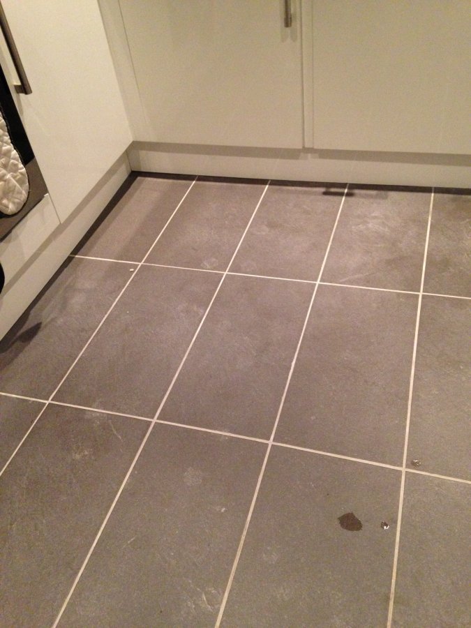

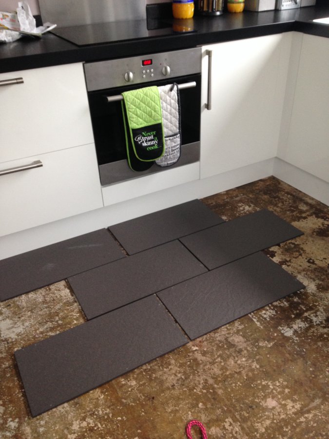

DIY isn't my strong point, so after my dog ate the Lino (yes my dog really did eat my Lino) in the kitchen I decided to tile the floor. As if it was that easy.
I chose these tiles: http://www.diy.com/departments/magm...31_BQ&ef_id=VrcwFgAAAX-UAE2K:20160209105449:s
The end product looks like this:image.jpeg
The grout has dried white near enough, and the tiles have a haze that I have scrubbed to no evail! They are porcelain unglazed tiles... To seal or not to seal. I have read and been told so many conflicting arguments on if they need sealing. Or not.
I am hoping someone will be kind enough to help a young lady in DIY distress and point me in the right direction.
Sealer? Revivor? Rip it up in rage?
Thanks :)

It looks to me that there is no way that grout is charcoal and if it says charcoal on it, the powder inside is incorrect. If it started of as charcoal and dried lighter, there is a mass of salt and sulphates in that you will find impossible to clean off and is an extremely poor quality grout. If you can get a sheet of White A4, tip some of the dry powder on and post a picture, we'll have a look and see. It should be almost jet black. Also if you can post a picture of the bag, that will also help.
That grout will need removing with a grout rake or something similar to a Dremel with a grout Removal attachment. The next step is to get the haze off the face using LTP Grout Stain Remover, to prevent contamination of the new grout. Get yourself a new grout that is efflorescence free, such as the Mapei Ultracolour in either Nero (which is Jet Black) or Anthracita (Very Dark Grey to Charcoal).

no they won't. The face will be produced with a nano-seal applied at the factory to close any micro pores that occur during the manufacture. However because of the rough texture, it could be worth you applying a temporary sealer like the BAL Protective Sealer, to make the grout easier to clean off.
Other more permanent surface sealers are available to aid cleaning, but they tend to give the tile a permanent wet "just washed" look. These bond to the surface and don't rely on a porous surface to stick. But bare in mind that these can scuff and will need to be re-applied every 2-4 years depending on the cleaning method and foot traffic, so are more of a personal preference than a necessity.
One other thing I should point out, is that the biggest cause of grout showing white patches is by adding too much water to the mix. This is what draws the sulphates to the surface as it dries. If the grout you bought was black when it started, this is a possible cause.
Sometimes when mixed as per the instructions, the grout can be stiff and hard to work with. Some people add extra water to make it easier, but my advise would be to persevere with the stiff stuff and don't be tempted to wet it down.
I'm not saying this is a definite cause but its one possibility you can count out if you did it as per the instructions.

Don't get me wrong it is possible on some tiles but it all depends on the absorption rate. So for example, the tiles daisy has the rate is (or should be) <0.5% (if you have any packaging left for the tiles, it may have the class which should be B1a which is the BSEN14411 classification for a dust pressed ceramic or porcelain with an absorption rate of less than 0.5%). However, for a quarry tile or natural stone it can be as high as 10-30% (sometimes more), which inevitably will be able to take in any moisture from beneath it. so any efflorescence can rise through to the surface. Glazed ceramic tiles can also take in moisture as the "biscuit" is porous. However because the surface is glazed can prevent anything reaching the face which is why it only ever happens on unglazed breathable tiles.
The biggest cause of this on a tile is rising damp which realistically, unless you have an extremely faulty batch of adhesive, is the only thing that these salts and sulphates can be presented from. So anything with a porous back may benefit from a light sealer (I still wouldn't be happy recommending doing this), but it will have no effect on an impervious tile which will cause it to form a barrier. But the efflorescence we are talking about for daisies situation is in the grout and the haze on the face which has probably only got trapped in the rivens and cavities of the textured surface but not fully ingressed in to the tile. Thats why once cleaned, a temporary sealer will be sufficient until after grouting as it will prevent the grout for getting lodged in the undulating face.
So baring in mind that this particular type of porcelain is impervious, the stain has to be from the grout on the surface to which a brick acid or specific grout remover (and a good scrubbing brush) will help clean the tile. But the question remains as to why the black grout has gone white, which I believe is still down to either a faulty batch or excess water in the mix.
