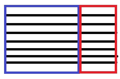

I'm about to remove the floorboards in my bathroom and replace with 25mm plywood. Due to the size of the room i'm only going to need 2 pieces of plywood and as such the board will be following along the joists (and as such is never unsupported). The gap between the joists also seems to be about 40cm.
Due to this am i correct in saying they'll be no need to use noggins?
Please see attached image for clarification - the blue and red boxes indicate the two plywood boards.
Unfortunately not; you must use decent size, well fitted support noggins between the joists to support the board edges where they meet in the centre of the room or it WILL crack. You don’t actually show any but I’m assuming there are joists at the perimeter edges of the room (top & bottom)? Noggins are not normally necessary on the two unsupported edges on the perimeter across the joists (left & right) unless across a door threshold or an area subject to any sort of loading/traffic.
You must use WBP ply, not ordinary ply & seal the underside & edges with an acrylic/SBR primer; do not seal/prime the top tile surface. Fix down with screws every 150mm into the joists/noggins
Only use quality trade adhesive & grout of the correct type for your tiles, the cheap DIY stuff is mostly crap. Read the tiling forum sticky & archive posts to avoid making disastrous & potentially expensive mistakes. What are you doing with the walls?

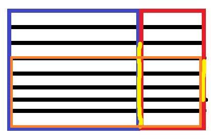

There is also a door threshold on the right so i'll put noggins in that area too. I've also now updated the image to include the new plan - the yellow indicates the noggins and the orange square indicated the area to be tiled.
As for the noggins is there a specific size and type of wood i should be using?

Plain old 4” x 2” sawn will do. Make sure it’s well dried (to avoid any shrinkage), the noggins are tight fitting between the joists, position so the boards meet in the centre & put 3 layers of glass fibre overlapping mesh (plastering tape will do) tape over the join; use screws (10’s or 12’s) of a suitable length, don’t use nails.

After a bit of investigation this weekend to make a decision on materials to buy I’ve realised that removing the floor boards and laying down ply isn't really feasible in the time and budget contraints. The main reason for this is that i assumed the left wall would have a joist under it but this is not the case. Running some noggins between the two joists isn't possible either as there is pipe work running parallel to the wall.
As such i was wondering if fixing down by 16mm T&G floorboards with some 60mm screws (and replacing any rotten sections) and then overboard with 'no more ply' would be acceptable?

16mm T&G floor boards? T&G flooring is usually 18mm! Is this going to be over the top of existing floor or is it replacing it? What sort of T&G, not chipboard I hope! I don’t normally use NMP for over boarding; 12mm WBP, Hardiebacker 500 or even 250 would be better IMO. I can’t see how doing this is going to be cheaper than replacing the floor with WBP?
Taking shortcuts is a false economy; your floor must have no perceivable flex or you risk tile failure & that will end up a lot more expensive than the time & a little additional expense involved in preparing the floor well in the first place.
The problem is the wall at the bottom of the picture above (which is parallel with the joists) is resting on the floor boards going into the other room rather than a joist. This means if i want to remove the floor boards and lay plywood instead I’m going to need to have something by the wall for the plywood to lay on. The only way to achieve this is to lay noggins going from the last joint in the bathroom to the first joist on the other side of the wall. The problem with this however is pipe work running parallel to the wall in this area so I can't achieve this without getting a plumber out and re-routing the pipe work.
At the moment the floor in the bathroom does creak but I’m guessing if i screw this all down (it's just nailed in at the moment) this will solve this. It is also definitely 16mm T&G softwood timber.
As for not using NMP could you please let me know why? I know it's all marketing but NMP seem to suggest it's a direct replacement for plywood and i can't say I’ve seen a bad word said about it. Is it a case of NMP doesn’t offer structural strength buy plywood does?
