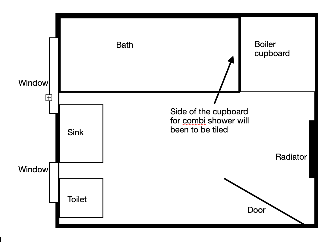

Hi i'm having an old bathroom ripped out and the room skimmed. Boiler is in the bathroom and the cupboard for the boiler is being built in after it's skimmed. and then the side of the boiler will be where the bath and shower go. so the shower will be attached to side of the cupboard.
I've attached plan (not to scale) what would be the recommended process for making sure this side of the boiler cupboard is suitable for tiling and attaching the shower too?
I don't have option to redesign layout or move the boiler.

Fix some Wickes Aquapanel to the cupboard side and the tiles will stick perfectly.
You can get a great fixing for your shower attachments through the tiles and panel - even more so if the boiler cupboard is made from ply or whatever.
