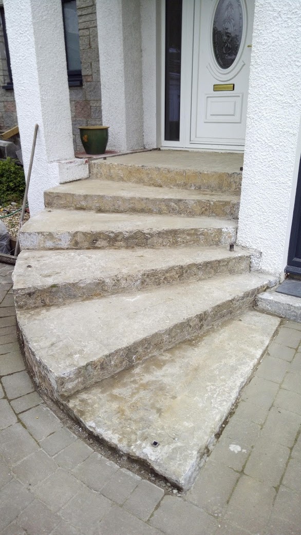

I'm about to take on a tiling job that will push the limits of my abilities! I would say I'm quite comfortable tiling Bathrooms & Kitchens having done quite a few in the past. However, these steps will certainly test my ability. So was hoping for some advice regarding a few questions I have.
I have attached a picture of the steps in question, which should give you an idea of what I have to do. Although its worth noting that the steps have been relaid with Granite/cement and have a much better finish (Level) than the picture shows.

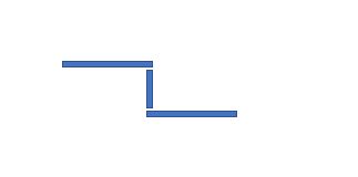

So, when tiling the nose of the step, I intend for the upstanding tiles to be 'on' the lower tile (a grouting gap will be used too) and the upper step to be on the upstand. As per attached 'Tile doc'. My question is, should I have a 'grout line' between the top of the up-stand and the underside of the upper tile, or should the upper tile sit directly on he up-stand?
Also, as you can see the steps curve, so I will need to cut this curve in the tile. I intend to do this with a Diamond Tip Grinder blade then smooth off the finish with sand paper. However, this cut edge will be left exposed. Do you have any suggestions how you would finish this? Ideally I would colour it to match the colour of the tile (Anthracite Grey).

you want to cut the remainin metal post stubs flush with the surface. use metal blade in angle grinder.
you also want to cut back the render from any contact with ground or finished surfaces.
the first bit of peepin up riser is a toe tripper.
use custom external step nosings or the tread tile nosings will chip.
you riser tile in diagram is correct.

Thanks for the reply, I have removed the stubs and resurfaced the steps with a granite / cement mix. So each step is now about 20-30mm higher.
I had thought about nosings, (I assume you mean the metal strips?) They are quite expensive! But b=maybe the only option.
Do you have any ideas about the outer curved edge?

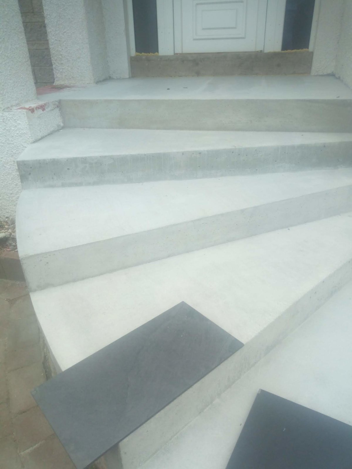

yes, they are expensive for what they are. ther are also curved trims for edgin but probly not needed for you.
i dont now what your tile is but should be ok doin what you say above - but first dry fit every tread an nosing anmark the curve before cuttin.
be aware its not easy settin out kite winders for tile - you dont want to end up with slivers of tile

Ive attached a updated photo of the steps showing new concrete and 10mm porcelain tiles to be used. Although these tiles will be 600 x 600mm not 600 x 300
