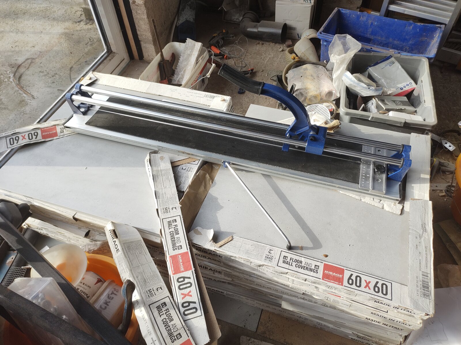

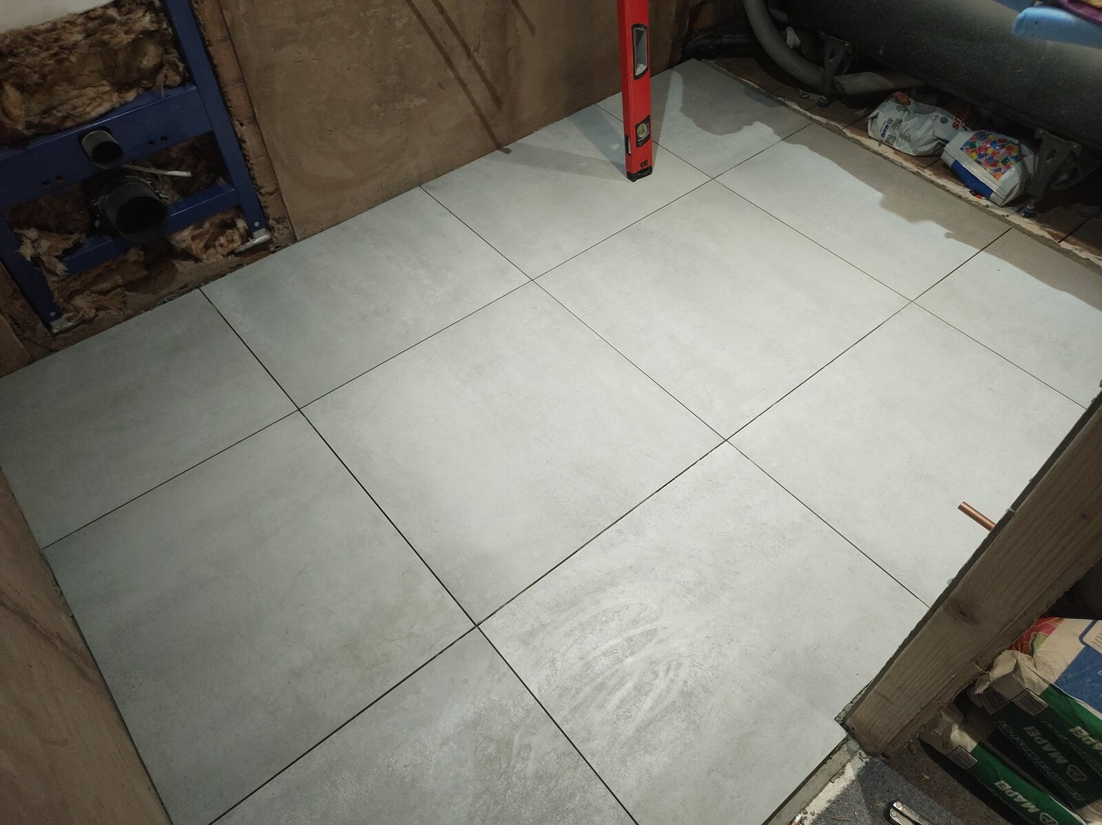

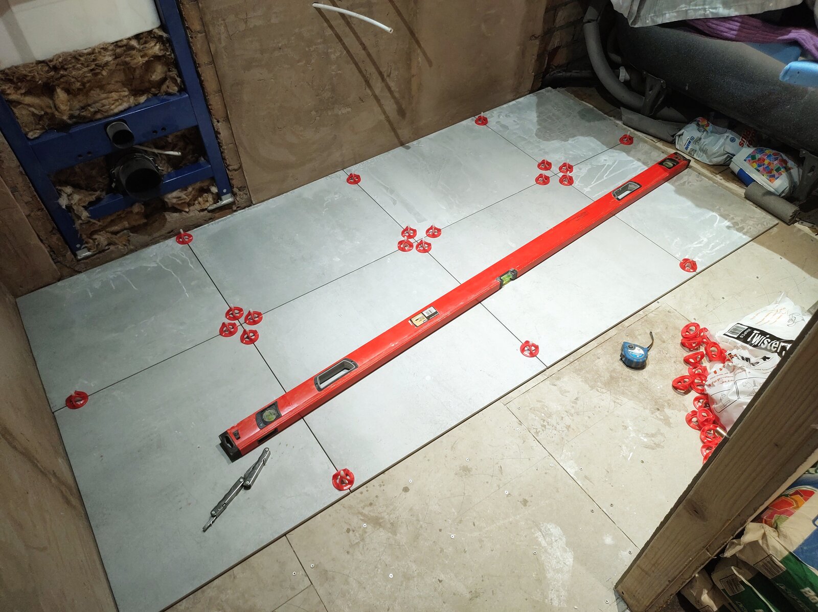

I'm DIY tiling my bathroom with 600x600 porcelain, the floor is: joists, boards, 6mm cement boards fixed with flexi tile adhesive and screws. I'm using Mapei Keraflex S1 (gives you hours to get it right) and the Shmox twister leveling system, 10mm square notched trowel (I'm wondering whether to use my 10mm U notched for the walls as I think they're a bit flatter). I'll be priming the (newly rendererd) walls with SBR. I'm cutting with a Vitrex 102390 (only a few quid more than the 600 version). So far so good.
