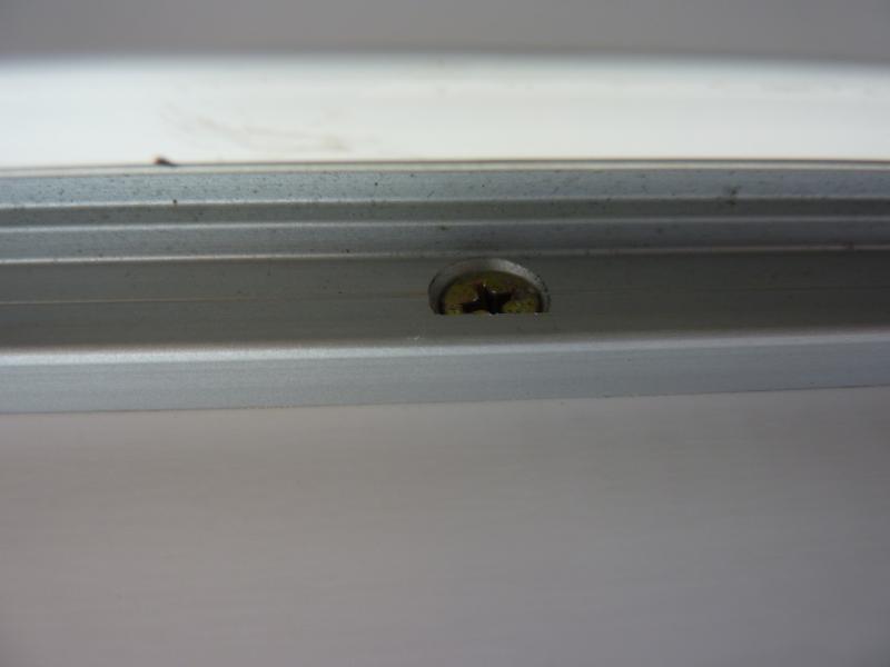

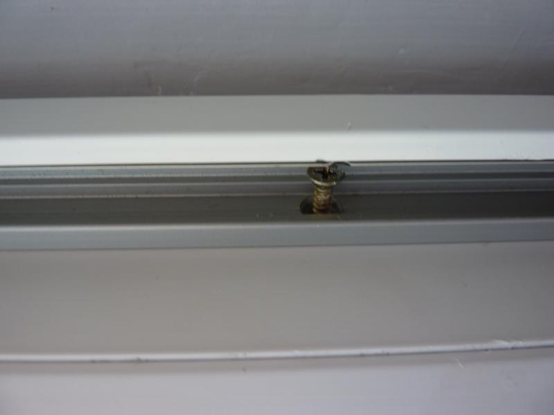

Hi, thanks for the reply.
I have obtained the necessary gliders from an online source.
My problem now is how to loosen/remove the channel in which the gliders run.
The 2 images show the location of the screws holding it in place.
I have tried to undo one screw, the first image, and have got so far but I am worried I will burr the screw head if I try any more as I have to push the channel upward to gain purchase on the screw and this of course tightens the grip of the screw as it's at an angle.
The plastic channel is a one piece construction so the only way to access the screws is from the front. I bought a flexible screwdriver extension but the angle isn't right.
The only other alternative I can think of is an ofsett hand tool (I assume the head is a phillips) but the gap between the 2 sides of the channel is quite small so not even sure if that would fit if the head piece is too long from where it bends (hope that makes sense).
Any suggestions would be much appreciated.
If it is like mine the white bit of the channel clips off, Try a Knife. Once you get it started it is easy. Once off there should be holes on the opposite side of the channel.
hope that helps[/b]
