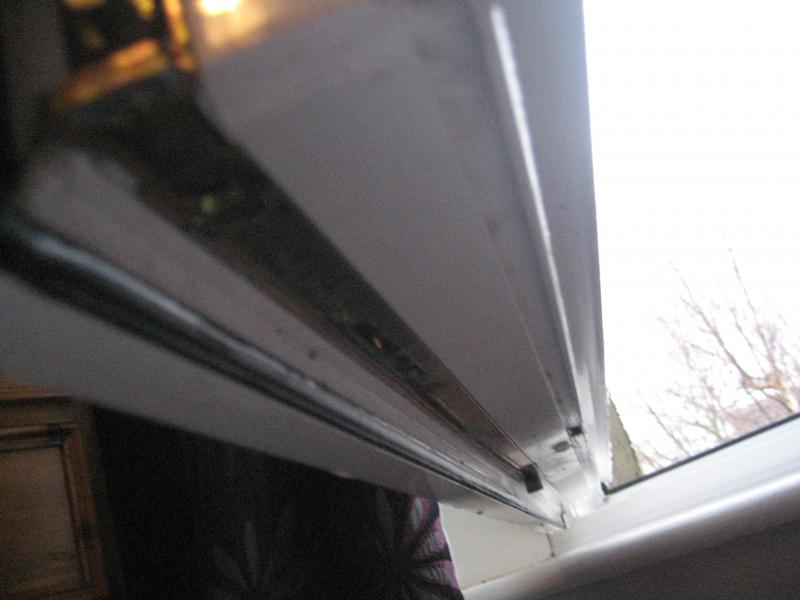

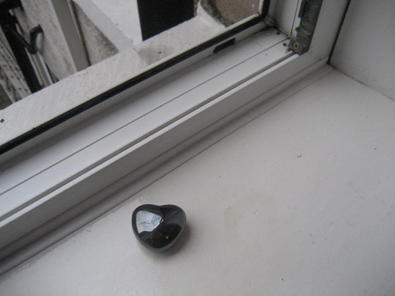

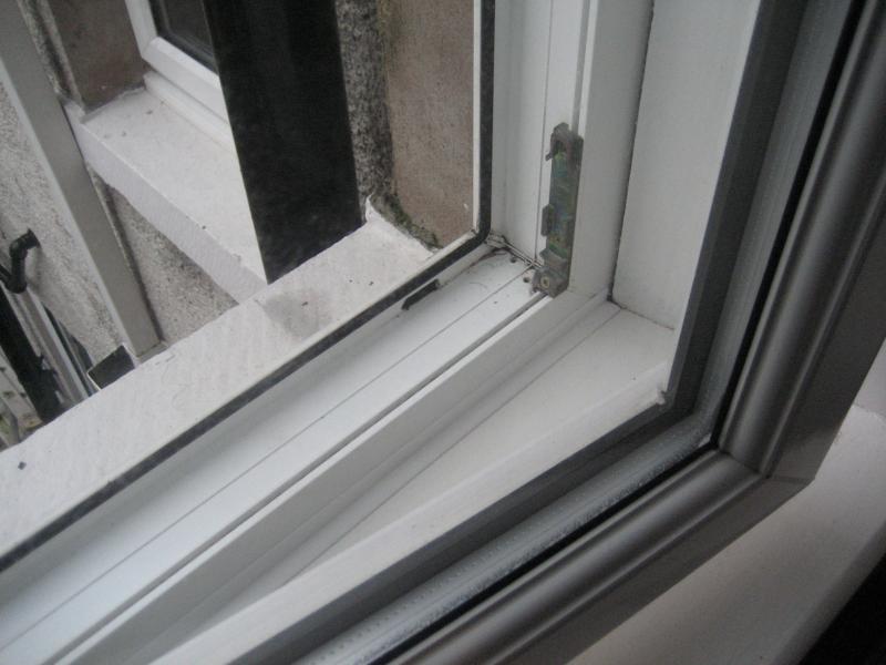

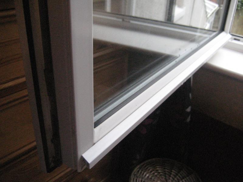

Hello group, I am experiencing a problem with a upvc double glazed tilt & turn unit. Whenever rain hits the South facing window it leaks in from the bottom, I had a double glazing firm out last year who fitted the weather strip on the window, this didn’t really help matters. I was then advised to drill extra drainage holes in the frame which I have done in the middle and at the end, the drainage channel is clear, poured water into it using a jug and it happily ran out through the drain holes. I don’t really want to splash out on a new window so any advice would be appreciated.
I have included a few photos below, note the stone designates where a stream of water is visible on the frame when raining.
Cheers group
Note: The window opens inwards

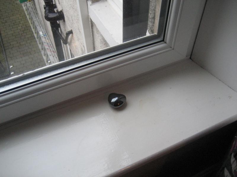

Thanks for the reply, if you look at picture #3, when the window has been opened during a rainy spell, the water is sitting in both the channels that I have drilled holes in. If you enlarge the picture you can actually see residual droplets in there..
How is the external drip fitted, you may need to seal along the top of it if water is running behind it

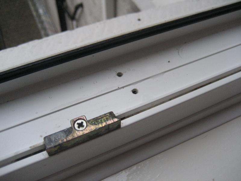

I rectified a fix for this, although not ideal it has worked and has been puddle free for months, I located the seep holes in the lower part of the frame, and drilled holes directly above them. The water simply drips/runs right out of the gutter. Like I say, not ideal but it has worked.

First thing you need to do is fill those extra drainage holes you added ASAP, they are in the WRONG channels!!! All they are doing is filling up the frame with water and quite possibly running down your cavity and can cause much bigger problems.
That's impossible, the drainage holes go direct to the window ledge, I can see the concrete sill underneath, no water is backing up.
