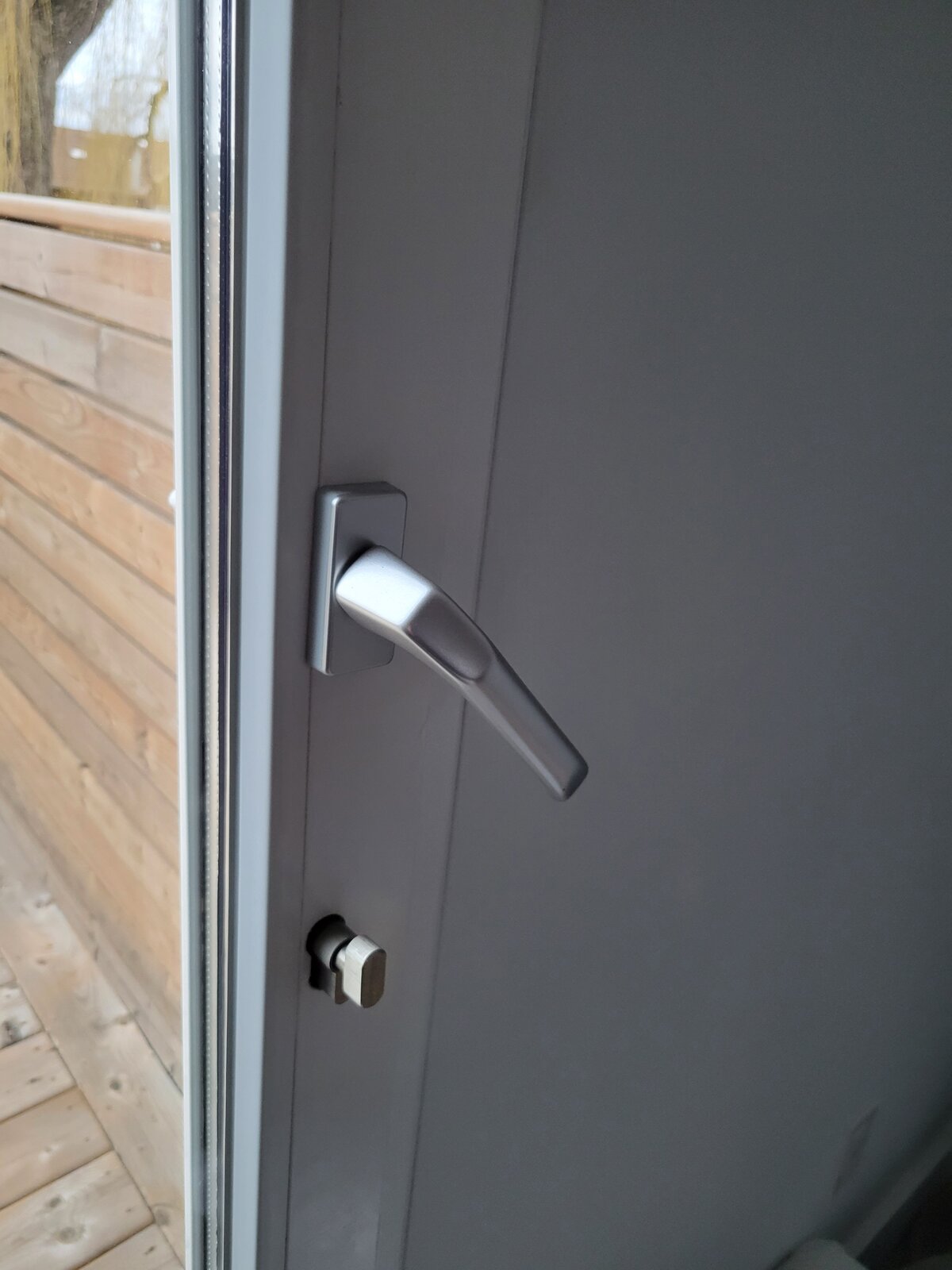

I have a tilt and turn door that operates in an unusual way. This is a left hinge hanging door; looking at door from the inside, the hinges are on the left and swings inwards.
The standard or typical positions to open/close/tilt the door should be as follows:
However, my door does this:
How can I adjust/fix this, so it operates like a standard tilt/turn door? Is this a gearing issue?
Note in the image of the "3 o clock position", this is the furthest it will go since there's siding on the exterior of the house that prevents a full 3 o clock position close.
I am in Toronto, ON, Canada so there's no service providers. There is no warranty on the door either as it was sold to us as a cash price with no support (even at the request for paying for service).
Any advice is greatly appreciated!
