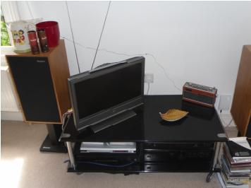

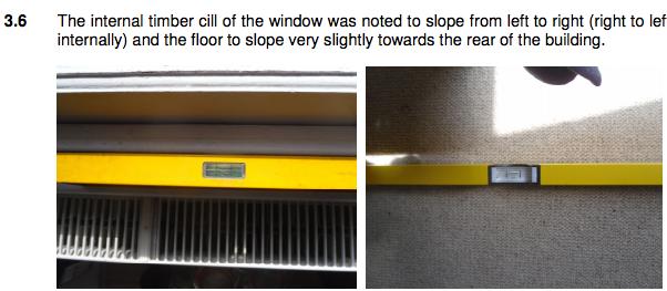

We are remortgaging our flat and upon the recommendation of the surveyor, we had a structural engineer inspect our property to confirm if the tree outside was causing any structural damage. The structural engineer concluded that the tree was of no concern, however he believed that the diagonal crack in our wall was caused by the timber joists in the window architrave opening slightly (known as creep deflection), and as a consequence the right-hand side of the window (as viewed internally) had dropped very slightly. I have attached photos of the crack and the level of the floor.
He said this was expected in an old Victorian building and not significant, however he advised that we employ a local builder to carry out further investigations on the supports.
My question is, what would these further investigations involve? How could we determine if there was a significant problem? And if there was a significant problem, what remedial work would we need to carry out?
Is this a first-floor flat, with perhaps a large opening below, spanned by the timber lintel?
Over time, these do deflect due to long-term creep. This leads to cracking of plasterwork above. Why did the SE suggest looking at the bearings of the beam? (pics of the outside would help).

Our flat is the second floor flat, but yes the first floor flat does have a bay window below our front elevation.

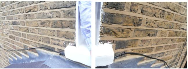

There are no cracks visible on the outside, however the SE said the outside had been repointed recently. I have attached another photo.
The SE was not specific as to what should be investigated, that's what I am trying to understand. Do you think he meant inspecting the bearings of the beam? In your experience how would you find out whether deflection has occurred?

I suspect he's just covering himself there. Timber beams do deflect over time - it's a fact of life.
The bearings for the beam will be within the flat below, and it's unlikely the people there would welcome builders having a snoop round, and the SE knows that.
If the crack in your flat is long-standing, it's nothing to worry about.
