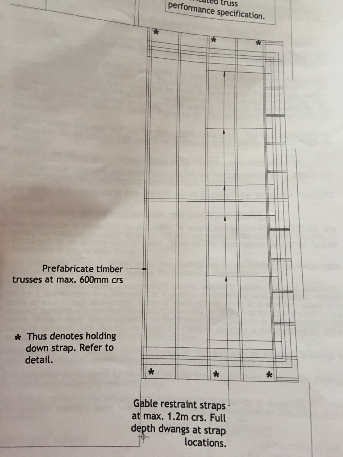

After a lot of searching through the internet I still haven’t found the definitive answer for this post, on my architects drawings for my second storey extension it states three types of restraint straps for the gable end alone.
The new build is a timber frame and i’m Not fully understanding where these three have to go, on a masonary build (as carried out previous) the eaves level would tie into the blockwork and across the rafter, but where do these go in a timber frame?
The new build is joining the existing gable end.
Wall head restraint straps (1000mm centres)
Eaves level gable restraint straps (1000mm centres)
Gable restraint straps (1200mm centres)
All of the above mentioned have to be strapped across three trusses and screwed into appropriate noggins,
Do the gable restraint straps attach the outer blockwork and fit under the gable ladders attaching the trusses by attaching to the underside?
Sorry for the long post, I don’t seem to be getting anywhere with my architect and there has been numerous details on the plans which seem to contradict themselves.
