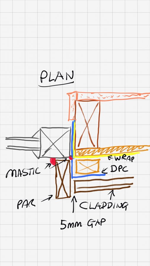

I'm building a decent size timber workshop/shed at home.
I'm effectively building it like a common US timber frame house, lined inside, 4x2 framework, insulated, breather membrane then cladding the outside with T&G tanalised shiplap cladding.
The windows and door are double glazed UPVC, I already have them, they were mis-measured units from a local UPVC place.
The window and door openings, I really want to waterproof them before fitting the windows and door and I can find lots of information on this on youtube and the likes with pretty specific instructions on cutting away the breather membrane, folding it back into the openings then starting at the bottom lining the timber rough opening with all weather self adhesive flashing tapes before fitting the window, then sealing around the window with the same tapes, like the below:
The thing is I cant seem to find anything like these sealing tape products here in the UK.
Would a product like Everbuild black Jack adhesive flashing tape do the job I'm after?
Thanks!

Here's what I did at the reveals. It's not as involved as those videos.
But you need to be careful of the detail at the frame head and cill.
indeed at the head I would normally cut the reveal framing pieces at an angle at the top and fit a similar piece across the head with the membrane lapped down over it slightly, and mastic underneath. Just make sure the angle is sufficient that water will actually drip off and not track back, you can cut a drip into it if you want but I have never bothered.
