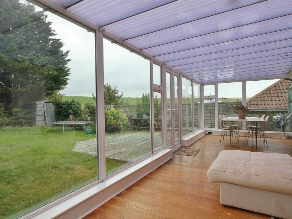

Got a few queries about conservatory improvements that I’d like to band about here as it’s useful to get a range of opinions. Did start looking last this a year or so ago, but got put on the back burner while we did other things.
We’ve got a 9m x 3m conservatory coming off the kitchen, about 4 courses of bricks then floor to roof windows on all 3 sides, panes are around 1.5m wide. Polycarbonate roof, very low pitch roof (Ultralite 500). The division between the conservatory/kitchen was removed before we bought the properly, so there is about a 4.5m opening to the kitchen. All the usual problems, extreme temp fluctuation, condensation, etc. Been living with it for the last few year while we’ve been updating the rest of the house, now it’s time to get something sorted.

I was just wondering if anyone had any experience as to whether replacing the roof and glazing would make a big difference and make the space more habitable. Still working on costs at the moment, but it's looking to be about a 3rd of the cost of an extension.
@Notch7, agree about a traditional roof and the weight, that's why we were looking at these lightweight thermal roofs. Floor is being replaced either way, condensation from the existing conservatory has ruined it.

Appreciate the reply. Would love to be able to do something that, but there is no blockwork to support anything. Also, because it's a bungalow and the current roof meets the house at the level the roof finishes, there's a really shallow pitch on the roof. It only drops about 30cm over 3m. I've attached an old image, you can see what I mean.
