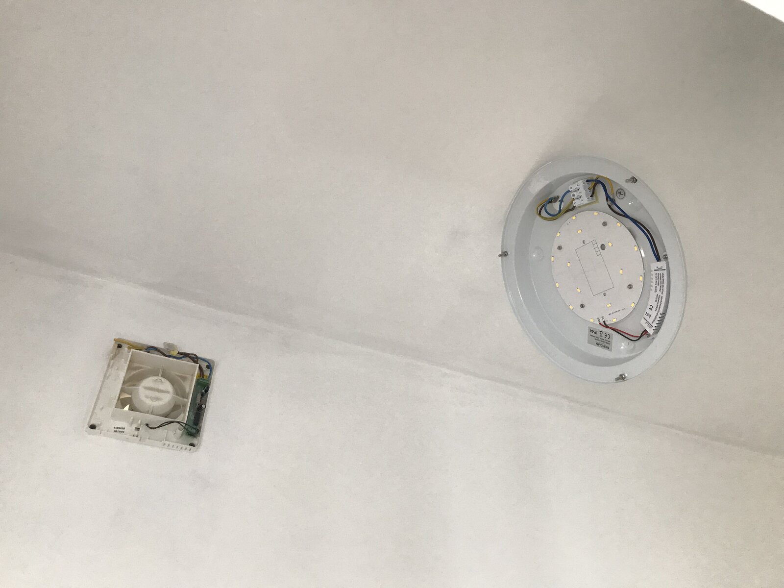

The latest discovery is that they installed a timed extractor fan in the toilet (which is what we asked for) but they wired it only to the light with no permanent live to keep it running after the light is off. Is there such thing as an extractor fan unit with a battery for the timer function?? Getting them back to fix it is just not an option so I’m thinking it’s that or putting up with it, unless anyone has any other suggestions???

The light fitting only has brown, blue and earth too. There is no access to above it as it is a groundfloor extension with a flat roof (it replaced an old outhouse).

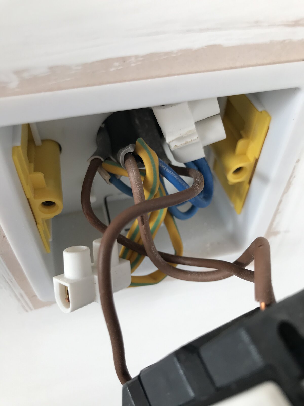

Thanks. In case the photo isn’t clear there are 3 cables coming out of the wall each with a blue, brown and earth. The 3 blue wires and 3 brown wires are all going to terminal blocks. 1 brown wire goes into one side of the switch, the other 2 go into the other side of the switch.
A close up of the fan wiring as I realised it wasn’t that clear before. Also thought it might be relevant to point out that it does have an isolator switch.
Need to see wiring in that as well.
What's missing is where the cables for the light and fan are connected together - none of the previous pictures show that.

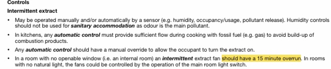

I’ve just discovered that, though we do technically have building regs approval, having a timer on an extractor fan in the room with no window is a requirement of the building regs so might get the builders back to fix it after all. .

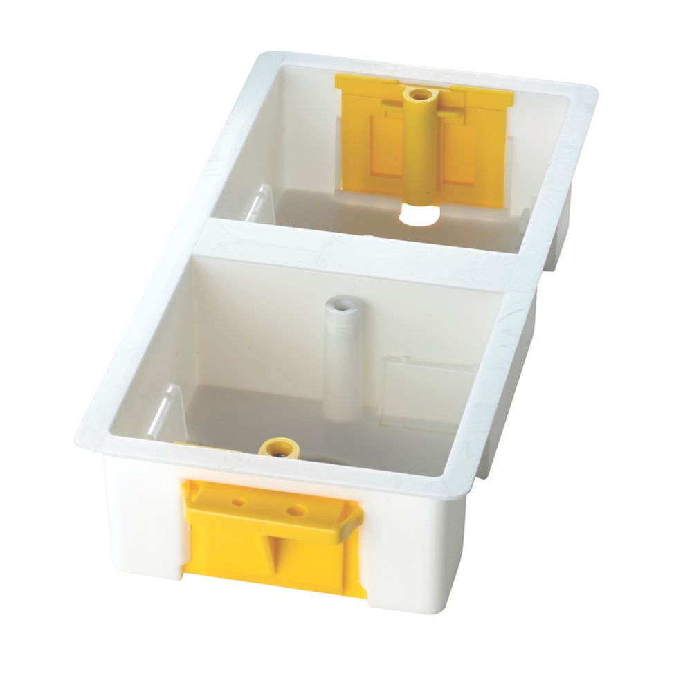

in a twin back box
ae235
