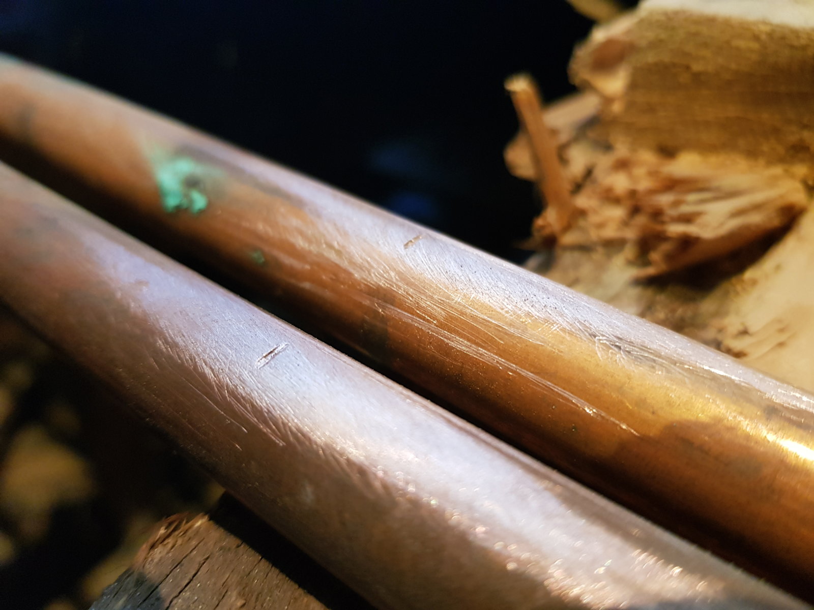

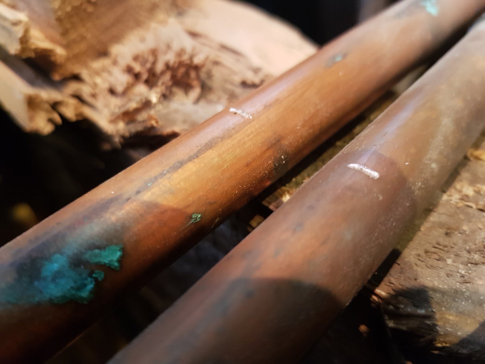

I was just using a Fein tool to cut out a rotten floorboard, I assumed the pipes ran deep as they did for the first metre, but then they came up right under the boards!
The nick is tiny, maybe quarter of a mm, it's impossible to measure.
Is this still ok? Is there a way to repair it or do something to make me sleep better at night
Photos uploaded. I sanded slightly to see the nick better
Better safe than sorry, solder a patch on both ,are they 15mm pipes ?
Yeah 15mm pipes. It's for a bathroom radiator.
I don't have the tools to solder anything. Could pay a plumber £60 to come out and do it, but seems a bit excessive!
I have quite a few speedfit fittings under my floor anyway, should I just put a speedfit straight coupler on?
Upto you how you do it ,Advised the easiest and quickest way ,without having to drain system . You could consider buying torch and flux and solder ...invest in the future !!

Solder on a patch without draining the system? How would you get sufficient heat into a pipe filled with water? I'm sure you know that but the OP might not.
I agree that soldering on a patch or a sleeve would be the best option though by far. Its easy to do and a blowtorch, solder and flux will cost you much less than £60.
self amalgamating tape. I'm not sure I'd drain the system for that.

But just to be clear, a small nick like this could cause issues if left as is? It seems so shallow, but then the pipe is only 0.7mm thick

A pre-soldered copper repair patch from screwfix is £4, a blowtorch £20 and flux about £3.50. You can repair both pipes for less than £30 and have peace of mind thereafter....
Why would you not want to do a proper repair ? The damage may never result in an issue ,but repairing it properly is a no brainer.
I guess I'm just wondering why not use a couple of speedfit straight couplers as I have them elsewhere under the floor. And as it would be my first ever soldering job, I feel like the speedfit would be more trustworthy don't you?
Yeah you're right, just trying to decide between speedfit straight coupler or buying all the things I need to solder these two joints, and learning how to do it.
