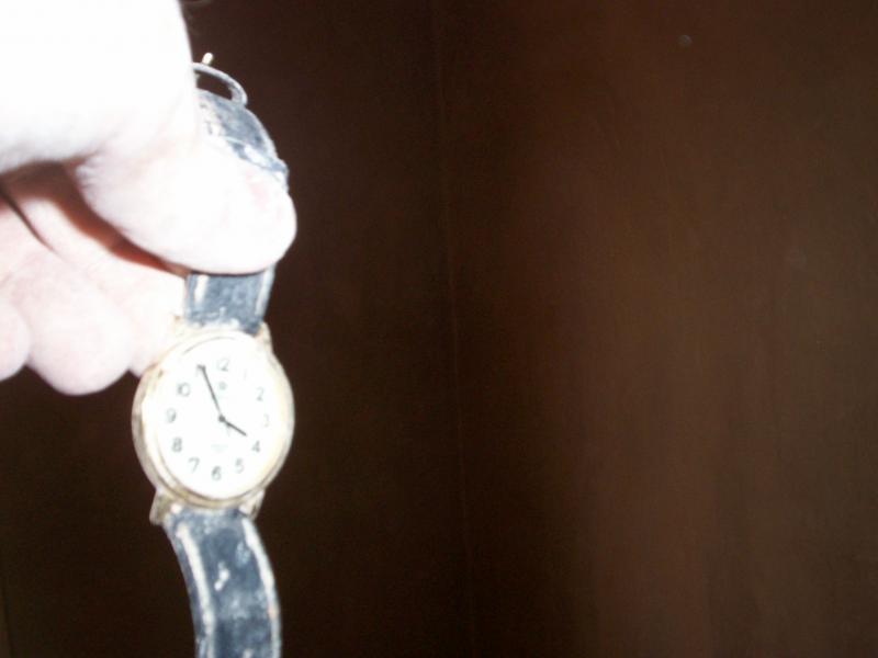

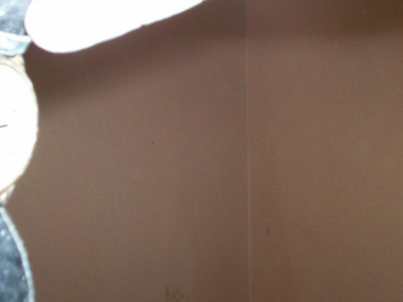

A twitcher, used on a "wet to dry" internal 90 degree angle is not a good idea,,,, but i have been using one on "wet to wet" internal 90 degree angles since the 60's. Not the same one of course :LOL:, but it's a great piece of kit, which i would not be without. The angles are "quicker and easier" to do, and are far sharper and neater than you would ever get, by using a trowel/small brush,,,, although i have done them that way too.
The wet angles in the pics below were twitched.

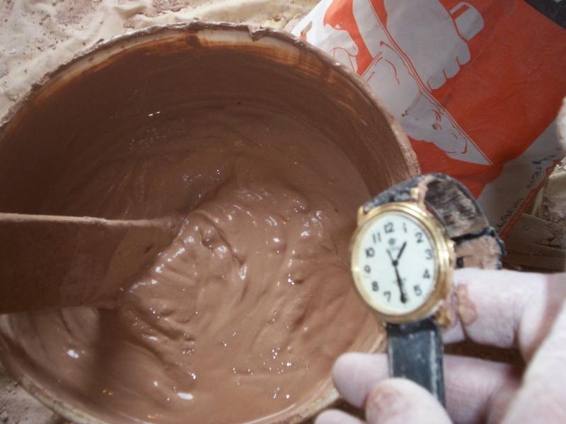

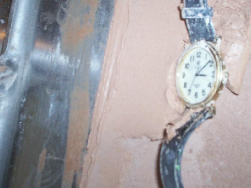

Seems a bit childish this, but last year, Joe90 and myself had a difference of opinion over the life of multi finish,,, you might remember it. I said that you could mend a scar/damage with multi finish, "one hour plus" into it's life. He said you couldn't, it wouldn't stick to the trowel,,, it would be past it. So armed with a digi-cam and my watch,, i went to work and took some pics. I coat my walls in the morning, with bonding coat first, then let them set up, so after lunch, 1.30pm, i mixed up some multi ready to finish the walls.
One hour and forty minutes later, with that stuff on the wall, (above), i could have repaired a scar/light damage without any problem. "Approximate" setting time for multi finish,,, 1.5 hours. The plaster finally set overall, around 3.55pm, i photographed that too, (below). It was just to prove a point really, oh,, and the watch,,,, it cleaned up a treat......... Childish or what?? sorry :rolleyes:
