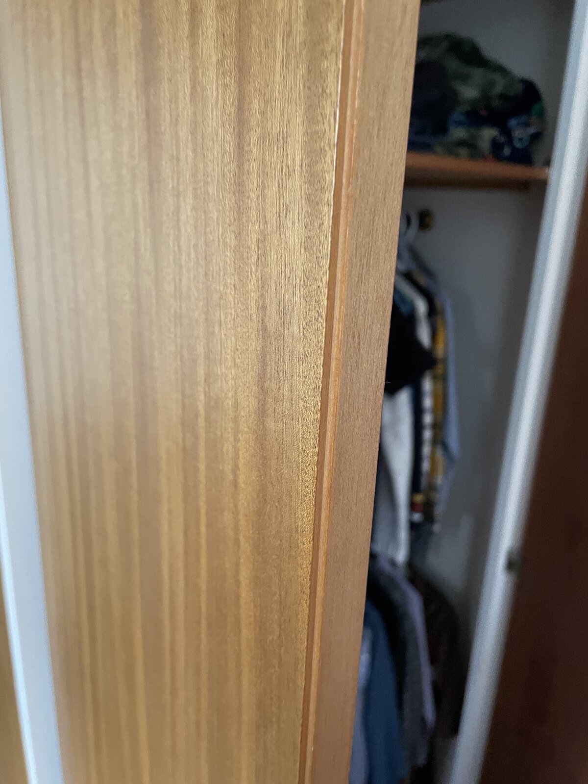

We have some built-in wardrobes that look like they’re from the 70s or 80s and we want to freshen them up by painting them in a white eggshell. However I’ve never used eggshell before and I recently had a nightmare trying to use quick drying gloss on some woodwork elsewhere. Is quick drying eggshell paint as difficult to use as quick drying gloss? Also I presume I’ll need an undercoat, but I’m not sure if I need a certain kind for eggshell primer?
The wardrobe is some kind of high quality plywood with a thick outer layer that can be sanded quite easily.

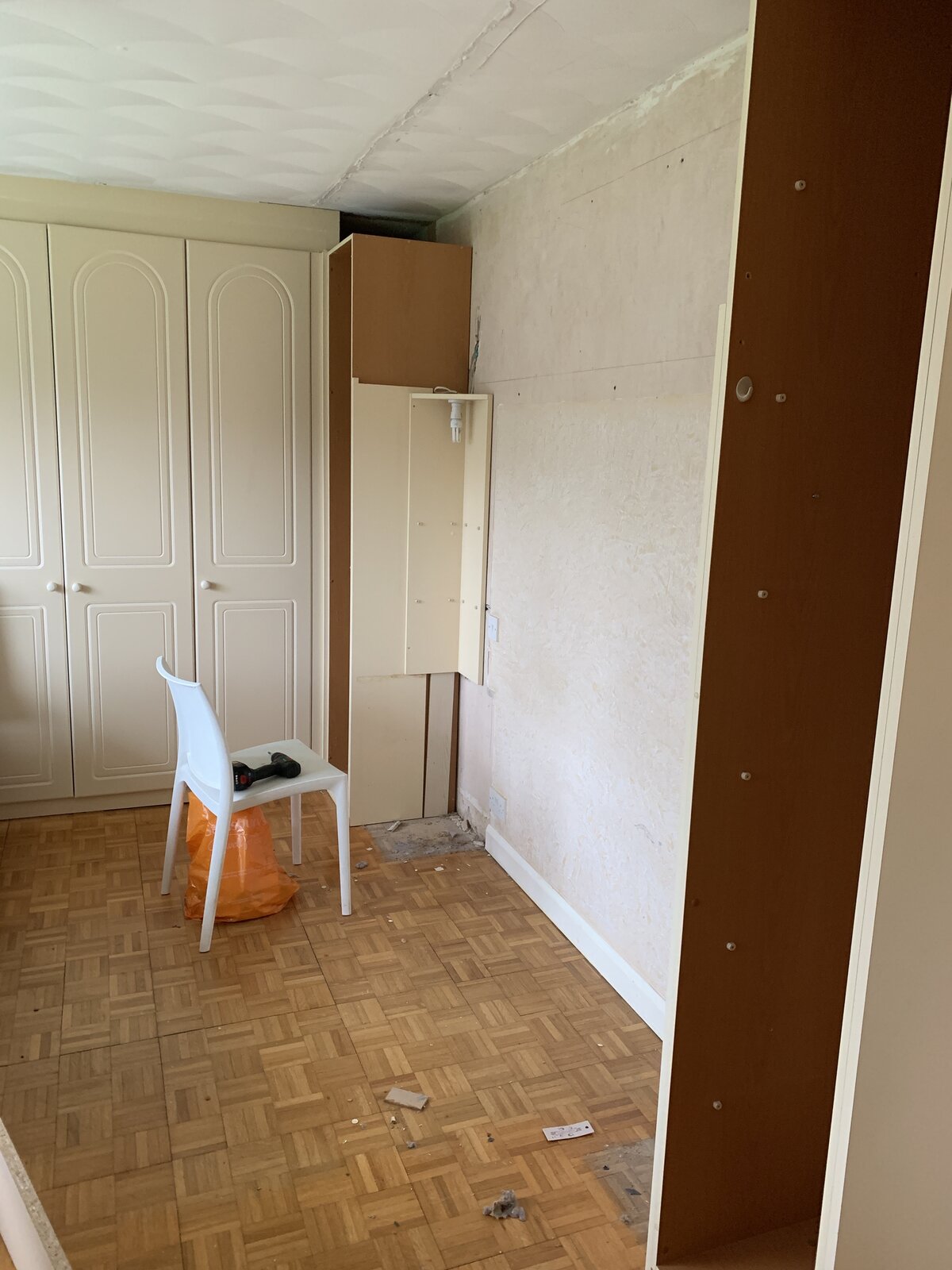

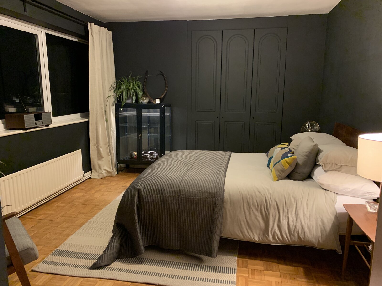

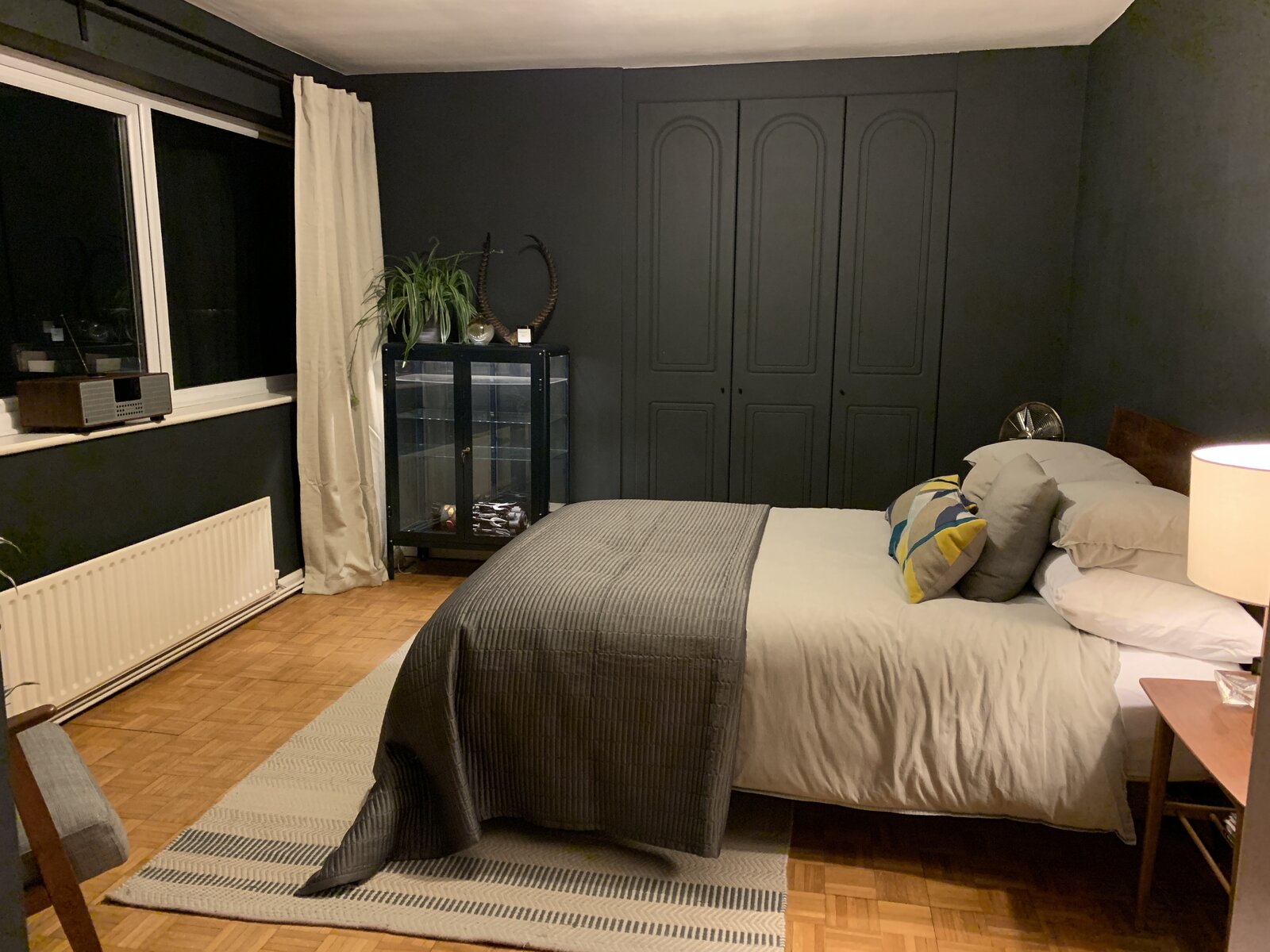

I did something similar a few years ago. Definitely do a light sand and then use a primer. I have had no issues with the new paint scratching off etc
