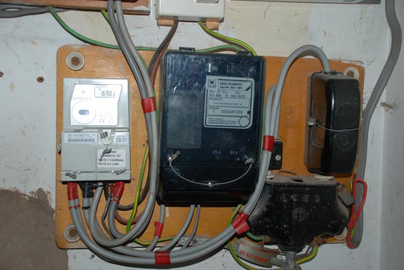

I will apologies in advance as I have no picture but I'm going to describe my earthing set up.
The main L-N wires terminate before the main fuse in what seems to be some sort of metal block (Almost like a up turned triangle) the earth cable has been fastened below this around the incoming cable.
So I have an earth cable from the consumer unit to an earth block which I believe earth though the cable. Also from the earth block their is two more earth cables that seem to earth the out side of this triangle item one on each side.
Is this TN-S what does it mean to the choice of consumer unit? Sorry been reading another thread.
Now with image
Also the fuse carrier is metal and make 60amp max is this normal? Also a lot of green stuff has stainded the tile below should i worry
Lets have a picture, and things can all be sorted from that.
The green stuff sounds odd, most older mains head cables are a sort of SWA with tar, if they over heat tar drips.
Green gunk tends to be older PVC TE which can have reaction that causes green gunk to drip. Such an action tends to be fatal and requires the offending TE to be replaced.
see //www.diynot.com/wiki/electrics:cable_types:green_slime

By the way, they may refuse to connect to two lots of meter tails, as you have - they arent supposed to double up in the meter terminals. Buy a DP henley block, and a length of tails.
Before meter man arrives, fit the isolator in its desired position, and fit a length of tails suitable to reach the meter's intended position. When the meter man arrives, ask him to connect to the isolator only, and leave the existing tails hanging. When he's gone, connect the henley block to the isolator with another length of tails, and connect your existing tails to this. Then turn on the isolator. Tidy up the tails while you have the chance.

I was a bit worried as the cooker CU is actually pushed into the meter and doesn't seem to fit at all in fact it is cable tied to the other cables.
Anyway back to the man question is this TN-S and if so what dose it mean to your choice of CU
looks like it is TNS, your pic cuts off the important bit
The earth to the supply cable joint.
You possibly read a post about metal cu, and rcd s with TT systems, which you dont appear to have.
The earth is just seems to be wrap around the incoming so guessing its off the armour
