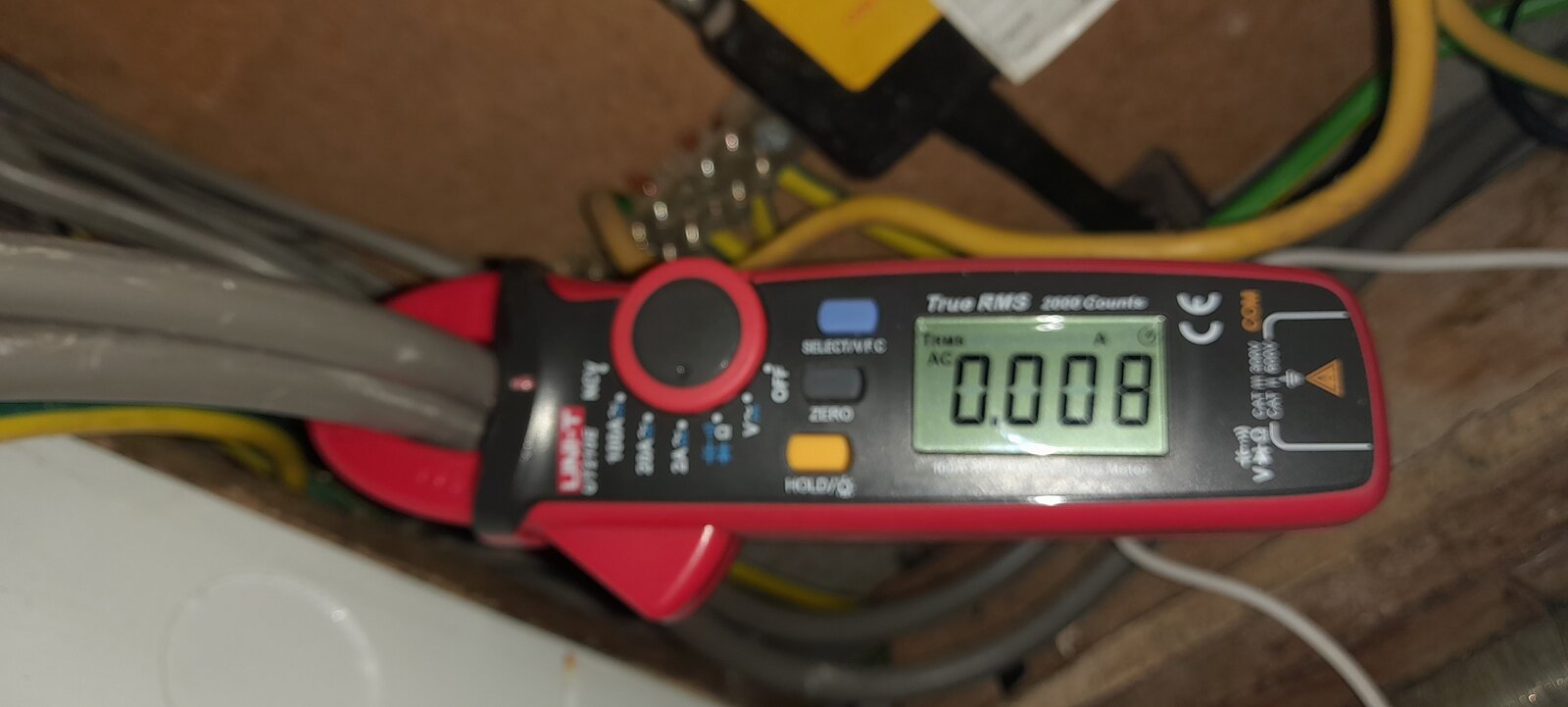

A loop impedance tester checks the volt drop with a load and from this works out the resistance of the loop. So it should show any problems with the earth, but this
is the cheapest one I can find, at around £70, so likely better to get an electrician to test.

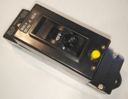

As to RCD again the meter Diffrence line neutral 8 Feb 24.jpg costs around £35 to test leakage, and if the voltage is DNO earth to true earth the RCD will not switch it off, or detect it, the old ELCB-v did ELCB-v.jpg but these are no longer used.
