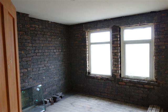

I'm renovating a house which has had to have a number of windows replaced. Now, the issue is that the internal reveals are approx 2" to 2.5" wider all around than those outside, and as such, required making up somehow. What I have done is built a solid timber frame to surround the window, then clad this with 1/2" plasterboard to bring it more or less up to internal wall level. All internal walls are back to brick and are being roughed and skimmed when prep is complete.
My question is this....
If the point where the new frame / plasterboard surrounding the window meets the existing brickwork of the walls is meshed tight with EML, then S&C rendered before plastering, is this a solid enough backing to avoid cracking later.???
Of course, I have the option of rendering up the reveals as they were and using a hideous wide PVC trim to make up the difference in the reveal, but really wanted to get a good clean finish with no PVC trims. The look I'm after is one where the window appears built into the wall properly.
Any views on this.?

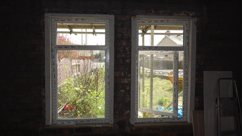

The image below here shows what I have done, and it's the join between the plasterboard cladding and exisiting brickwork which concerns me.
Would this area be ok to be roughed over after strapping it over with EML.?

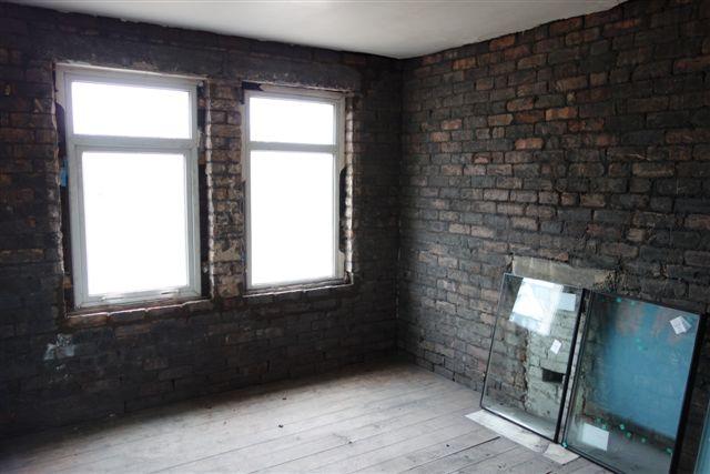

The images here show what the reveals were like before anything was done with them. One shows a side on view on a single window and the other a pair in the same room. These have some plastic trims on which is exactly what I want to avoid.
The gaps around these reveals once the trims were removed were as much as 2.5" to 2.75".
What would be the best way to get them done without the trims?

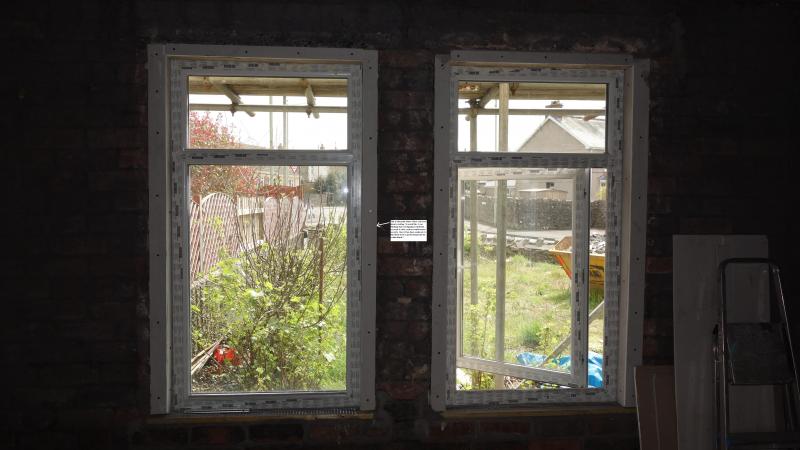

In the image here, there is a small dialogue box with text in, though I'm not sure you can zoom into it to see it as you'd have to. (Sorry am not sure how to post it already zoomed in).
This shows the point at which I have concerns over cracking. It's the point at which the face of plasterboard cladding butts up to the brickwork, and not anywhere near the plastic of the window frame.
I understand about having a straight edge, left slightly proud to bring the render coat out to, and my plasterer has said not to worry over that as he'll sort how he likes it to be. It's the gap between existing brickwork and plasterboard clad timber frame. This is what I see as a potential weak spot, and, why I suggested metal lathing to reinforce.

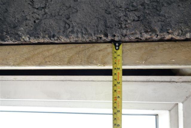

Looking through your pics there, your window with gaps and the twisted lintel doesn't appear anywhere near as bad as the windows I am referring to. If you take a look at the image attached here, you can see just how wide these gaps were in places. Also, as I'd only just started to rip these out, the plastic trims used to cover these gaps is still in place here and there. This is 2" wide trim, and the gaps behind them once removed are almost as much as a brick thickness. They were ridiculous.
My questions is.....
If they remain framed with solid timber as they are, screwed in tight around the whole reveal, with the plasterboard cladding over that and EML screwed over the joint between edge of plasterboard and existing brickwork, will that offer a solid enough base to avoid cracking.?

This is an image of the gap at the head of one window still to be sorted.
Believe it or not, this gap is less than at the sides by some margin.
