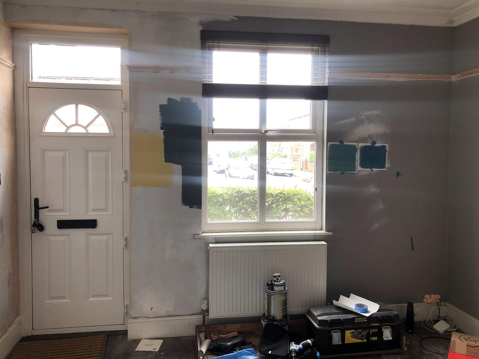

Hi everyone, been trying to get a definitive answer on this. First off I am not a DIY'er but a first time buyer of a Victorian mid terrace (2 up 2 down) with a north facing living room (brick wall, no cavity).
I'm anxious about the combination of a cold north facing living room and hideous fuel prices come October. Someone I know (a competent DIY'er who owns and maintains a few terraces he rents out) suggested internal insulation using thermal boards for the inside of this external wall using dot and dab.
The concept sounds great but I'm worried about developing damp/mould - how is this avoided please? My guy is convinced it wont be an issue. Any recommendations for thermal boards? Dot and dab or battens? The builder who did my kitchen isn't keen and doesn't think it's worth it and suggested a thick curtain over the front door and window and thermal wall/lining paper instead.....thoughts on this?
On said wall there is a window (double glazed) and a front (composite) door that leads into the living room - not sure if this info sways opinion. The wall is 3.87 m. I've attached a pic - ignore the paint swatches!

While the insulated plasterboard will certainly help, it would be quite difficult practically to do. You will have to move/adjust the radiator and also your nice skirting, coving and picture rail would be lost - or need to be replaced, which will be difficult for the coving. All to accommodate the new depth of wall.
I can’t tell how big the room is, but that radiator looks undersized. Also check to see if it has foil behind it. Additionally having the radiator in front of the window is not the most efficient thing…but sometimes is the most practical for the layout.
Personally I would increase the size of the radiator, and check the door and window fit well so that they close properly and seal without gaps. Next step would be a thick curtain across the door and the window (ensuring the curtain goes behind the radiator to keep the heat in), lastly it would be the insulated PB.
Perhaps give it one winter first to see how good or bad it is first, because the Pb and all the necessary room changes will be expensive.

with the door and window taking up nearly a third of the wall I can't see the insulation making much difference. Any draughts round the door, esp the letterbox would be first to sort out. it is a small room to start off with, a couple of inches off the wall will be noticeable. How well is you loft insulated?
As pointed out it would be complex wall to do, would you keep the cornice for instance... - this would be a big job to get right and look good with minimal savings at the end of the day.
how would you deal with the side bits around the window, these cold spots would become a magnet for condensation.
the real solution is getting together with your neighbours and going for external cladding - even then, that could be a 10 year pay back or more.
A terraced house does not have much exposed wall area so this is not your first problem .
Your cottage design will have cold draughts into the living room from the door. Look at a door curtain with portiere rod. Get a lined curtain for the window as well as a roller blind
With that old fashioned radiator position you will need a radiator shelf for the curtain to sit on to prevent the heat going outside.

I've checked the BTU for a room my size (4681) and checked an equivalent radiator (same size, double panel etc) on B&Q's website and it should give a BTU of 6007 so in theory it *should* be enough?
