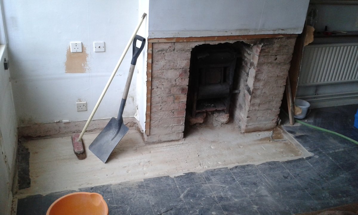

Hi All,
I need to level the flooring for the new hearth, which I remove from the previous extended hearth that goes lower than the floor level. Any advise what cement should i used to level it before i place the hearth. And by looking at the picture the next thing i should do is to level the base flooring and then place the hearth, is that right?
Many Thanks

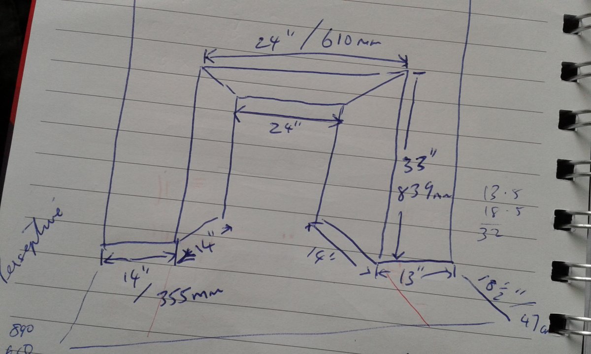

Yes it's for a woodburner stove. The opening width is 610mm, height 839mm and depth 355mm as the image below. Will this not fit a stove?

What stove have you got in mind? Is it certified not to raise the hearth temp above 100 degrees c?
Its going to need to be fairly small to fit and comply with building regs - have you seen the diagrams e.g. 26
http://webarchive.nationalarchives....gportal.gov.uk/uploads/br/br_pdf_adj_2010.pdf
Yes there are stoves that will fit, but if you go for one that wont heat the hearth, you can get away with tiles 12mm thick instead.
The opening must be in accordance with the appliance Mfr's Instructions and dimensions.
These can be found, often on line, in the manual of the appliance that you select.

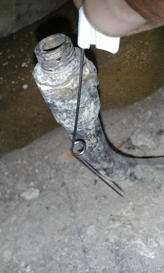

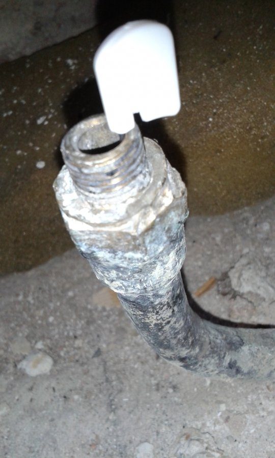

You have a stub of gas pipe showing - what do you intend to do with this gas supply?
When you remove whats left of the old appliance you will possibly have to do some draining down before removing it.

I am going to cut the gas pipe and put a blank cap on it.
Your abandoned gas pipe should be capped off back where it branches off from the main gas pipe tee. Perhaps thats your idea?
Its not best practice to leave an abandoned gas pipe in-place even though its capped off.
Regs say all gas work such as capping off should be done by a Gas Safe.

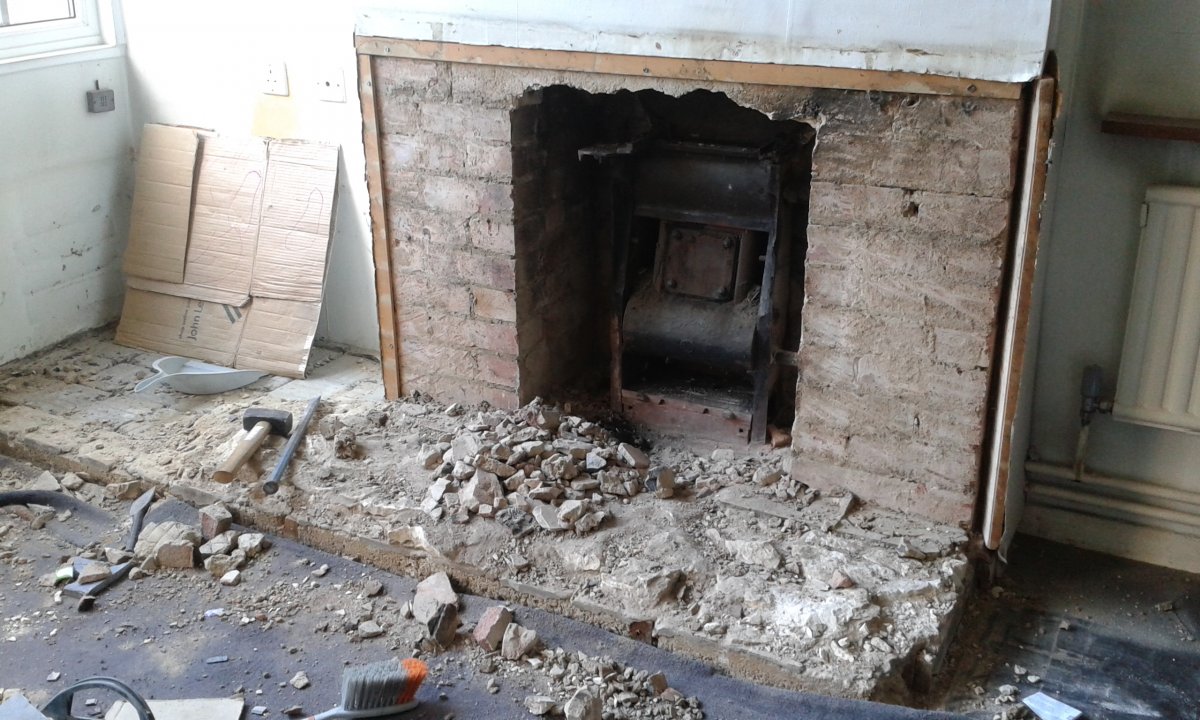

The Jab needs to be 500mm - you're a couple of inches short. You also have to have 150mm from combustables, it looks like you might be 100mm in places. You'll have to evidence that the hearth is 250mm deep, so unless you plan to re-instate what you just dug up, you'll need to dig some more..
Or you could go for any one of these: and just lay 12mm tiles or slate on top of what you have now.
https://www.directstoves.com/stoves/multi-fuel-stoves/l/yes.html
Yes i am going the raise what i have dug to the floor level. Current the depth is about 12mm.

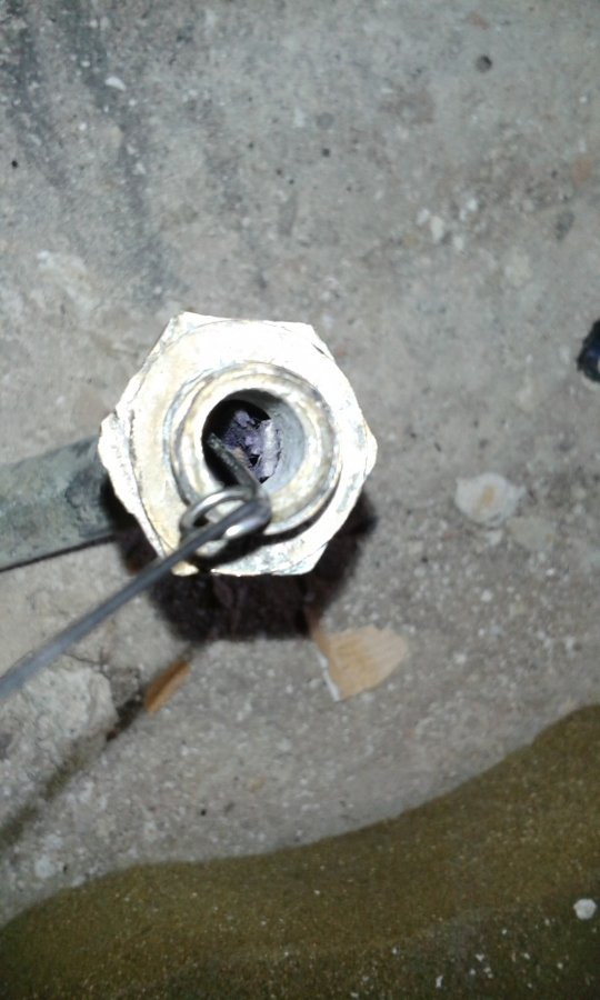

I tried to clear those little sand and stone on the gas pipe, just to check what's in it. I poked a pin and it went deep, as picture below. Does that look like the pipe has been cut off somewhere?
Can you not lift the floor boards and trace it back as per Vinn's post?

The pipe went straight to the concrete floor, i don't have a floorboards on the ground floor.
I only removed those particles in the connector and found nothing in it - as what it is shown on the pictures. I didn't turn the gas off on the main, I just clearing and cleaning the connector. Because someone told me that there should be a screw in it. He told me to turn it on to hear the hissing sound of the gas, but as the picture, i found no screw in it. So i assume it has cut off somewhere. However i found one pipe that might link to the gas pipe, which embedded in the wall pointing towards the gas pipe..
I'd get the HETAS guy out now to look at what you have now and then he can tell you what he needs doing. I'd strongly consider a stove that can work with a 12mm hearth though - it means you wont have unsightly steps in your room to trip over. It also make the room feel bigger. I'll snap a pic of mine and upload - its a similar size fire place and I also have gas pipes etc.
re your gas pipe if the pipe is open, the gas is on and there's no gas coming out then yes it has probably already been cut off. But as vinn says you should really trace it back to the main pipe as it is also possible that it has an isolation valve further back down the line which fiddling fingers may switch on in the future
