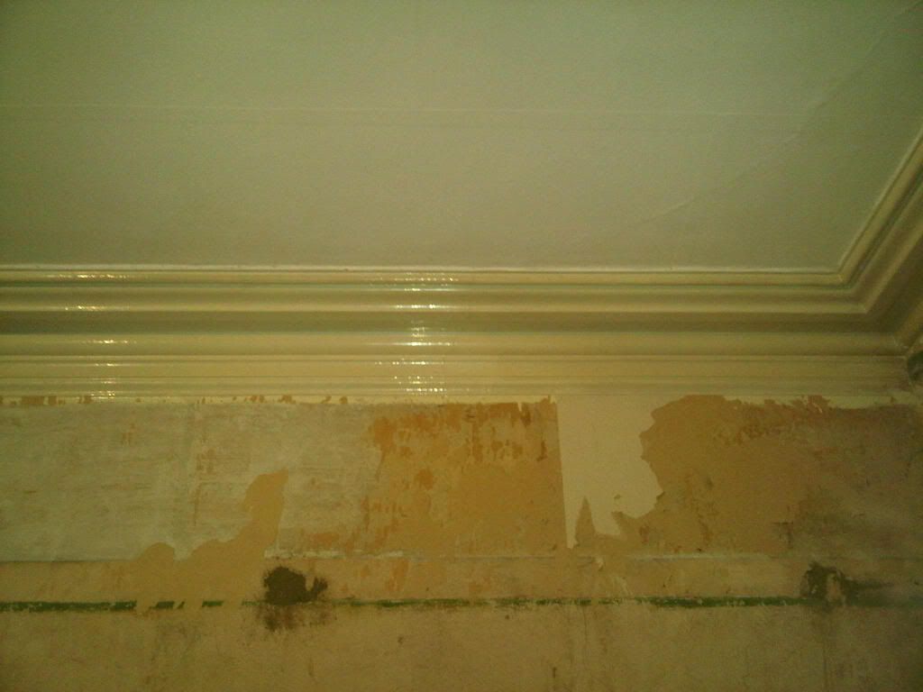

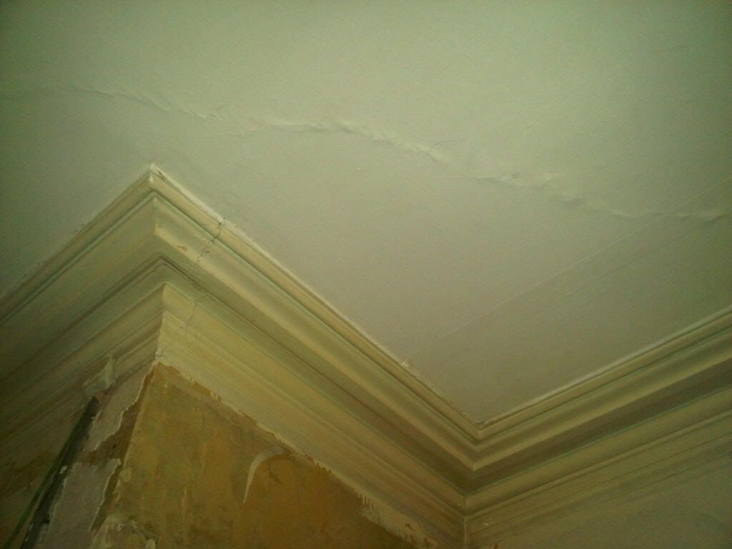

hi there
i just had a look and i dont think i have room for a 9.5mm board but looking at the pics below you will get the idea.
quite a bit of the cornice is also cracked and i worry that no amount of skimming will fix this ot if it does it will crack again and again.
Have a look see what you think
Be careful removing the wallpaper from the ceiling as it looks as if the top coat plaster may be loose around those cracks. If you push up on the ceiling is there alot of play?
I would say that your cornice would have been run in situ, and if sound,, looks worth keeping. I would also "not" overboard a ceiling that might be unsafe,, (and i'm not saying that yours is). Strip off the paper, and get a reputable plasterer to come in and give you his opinion on the condition of your ceiling. I've worked on plenty of them, and sometimes they look worse than what they really are. If it comes to the crunch, and the ceiling is not worth keeping, there is a way you can take down the ceiling, without destroying the cornice. You woud just need to cut into the "plaster", carefully, "all around the perimeter of the ceiling" with a stanley knife or similar, about 3" or so, out from the cornice. "Don't cut into the wooden lath". Once you have cut into the plaster all around the ceiling, you can then remove all the old plaster from the lath. After all the plaster has been removed, this will leave you with the cornice still intact, and a 3" border for you to work from once you have re-boarded the ceiling. Make sure you remove all the debris/lumps from between the old wooden lath, as this will stop the new sheets of plasterboard sitting flat onto the lath as you screw it into place. Once you have the new sheets in place, your plasterer will tape all the joints in the sheets, and he will also be able to tape/join the new sheets to the 3 "strip of plaster you left all around the cornice. The ceiling is now ready to be floated and set to the original level of the plaster strip, and then any cracks in the cornice can be repaired. Once again, don't overboard a ceiling if it seems loose. If you do and the old ceiling fails,, it'll take the new plasterboard with it.
