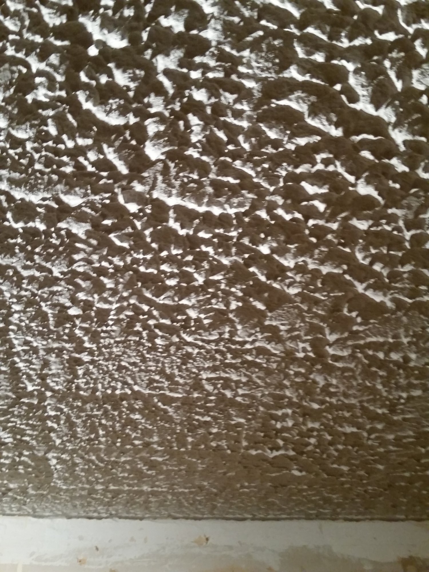

Im in the process of arranging to have one of our spare bedroom walls/ceilings plastered
My question would be in regards to the lovely 80's ceiling artex we have in our bedrooms - would a plasterer be able to skim this or would overboarding be required?
Ive included a picture below:

providing the artex is nice and tight the best thing would be to put a tight coat of bonding over the artex first and then skim.

If you are using that spray bottle to wet the walls no wonder you are struggling,you need a bucket of water and a decent sized brush to wet the walls well and a good stiff stripping knife .steam strippers are good but will blow the plaster on solid walls if you are not careful.Its better to get as much of as you can and don`t worry about scratching the walls this will help the plaster adhere as for the artex the plaster will be able to skim over that easy enough.
