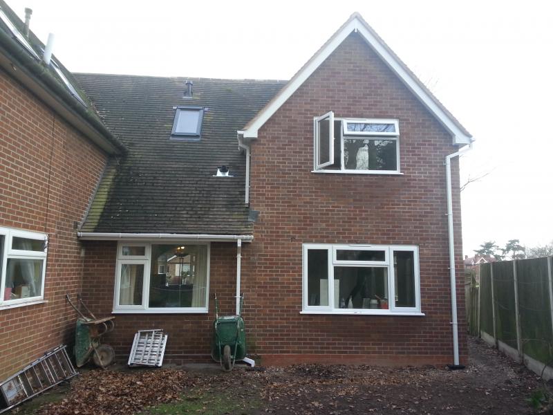

We built an extension on our property. The extension is stepped back and therefore uses wall starters. The old part was imperial bricks and the builder specified imperial for the new part so that he could match up the mortar lines between the buildings. After about 8 courses they were about half a brick out and when the old bricks were measured it became obvious that the sizes were all over the place - hand made and fired I guess. Thankfully we have a rain water pipe running down the corner anyway so you don't see it anyway. The builder was annoyed as the imperial bricks were about a third more expensive - you also get a lot less choice in bricks! So depending on how old the bungalow is (our house is nearly 200) you may not be able to tooth in anyway!
Eddieed, I'm assuming your builder was building up the corners first? If so why didn't he just gauge them to the existing rows using a piece of wood and a pencil and size his joints as appropriate.
Someone who built an extension in the late sixties on ours used imperial bricks like the existing, but completely screwed up their corner so ended up cutting into the existing bricks to tooth them. God knows how they got an angle grinder as I doubt they were common back then. Luckily I've hidden the mess under a new extension.
