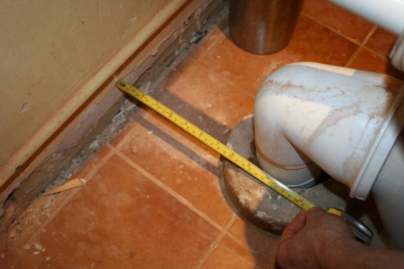

When ordering a BTW CC toilet for my recently retiled cloakoom, I thought I should check the dimensions. Unfortunately I realised it (ideal standard concept) would not fit as the centre of my 100mm down pipe is 245mm offset from the wall and the concept only allows 160mm!
So, my challenge is finding a subsitute. So far I have found the following which I believe could be used (at a push) with a '?' bend but neither is perfect:
1) Kohler Escale 235mm offset (discontinued and v. expensive!)
2) Roca the Gap 225mm offset (prob best bet if it will fit?)
3) Balterley Reflection 225mm offset (cheaper quality? will it fit?)
Do you have any other suggestions / experience to share as I promised the missus I'll have it sorted for Christmas - another challenge!
Make a 'box' from a timber frame covered with plasterboard with a 'shelf' just above cistern level?
What about sendng the pipe through the wall? The new WC pan may cover the hole in the tiled floor left by the current clay pipe.
