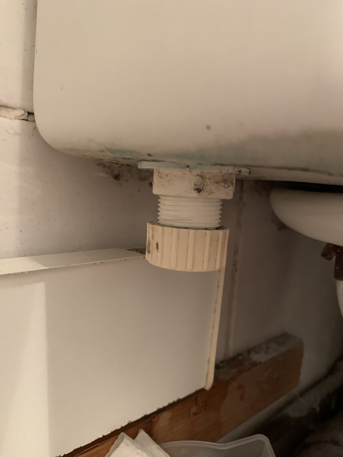

I noticed tonight that there was a small drip coming from a plastic fitting protruding from the bottom of my toilet cistern. I am guessing that the mains pressure to the cistern refill was a bit much for it and has caused it to fail.
I googled and at first thought that it was a simple cistern blanking plug that was needed but then also read about standpipe overflow. On looking in the cistern it had an overflow pipe which I assumed went to the toilet bowl but when I tipped 2 litres of water down to test it the result was 2 lites of water on the bathroom floor as it came flooding out the plastic fitting which the pipe is attached to!
I know nothing about plumbing but even to someone as clueless as me this pipe seems to serve no purpose?! Am I right in saying a blanking plug is what is needed to replace it?

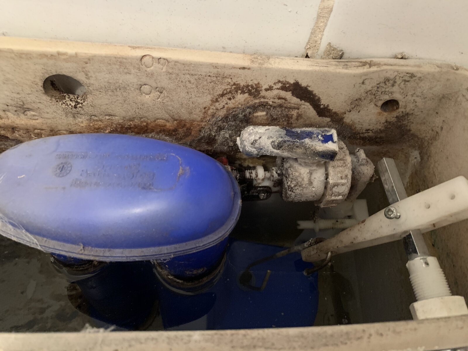

It appears that the overflow pipe has either never been connected, or that it has been removed. You need the overflow if there’s ever an issue with the float/ball valve not shutting off properly. You either need to reconnect overflow, or blank off if there’s an alternative overflow option, such as a syphon with overflow capabilities. Post a photo of cistern to include this please.

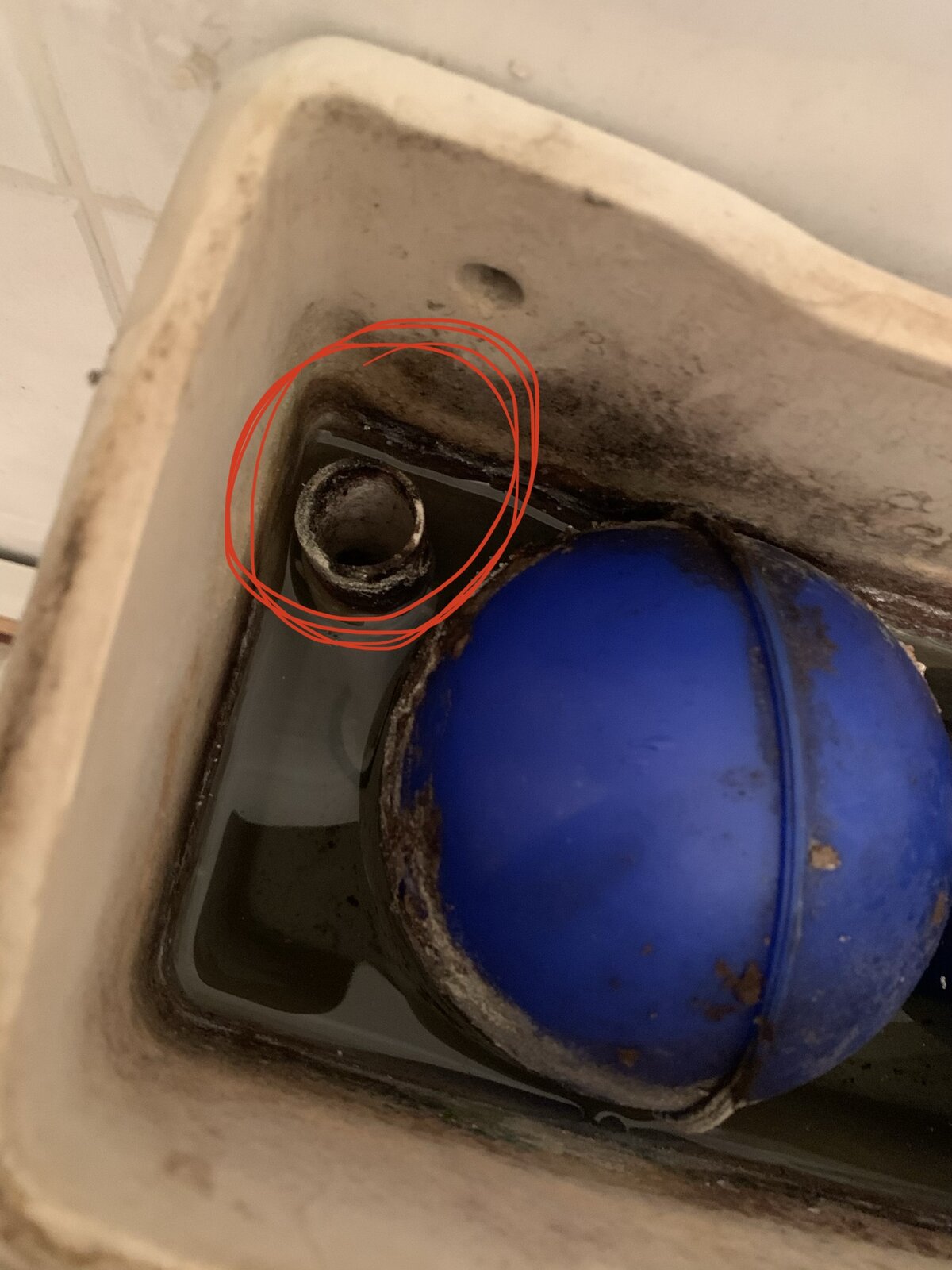

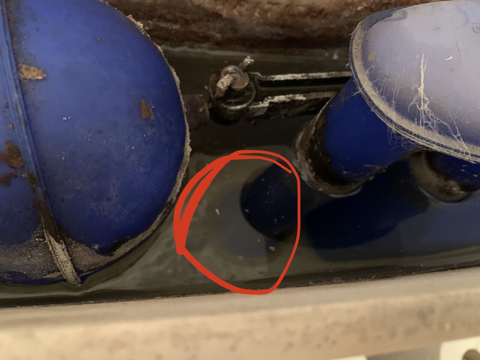

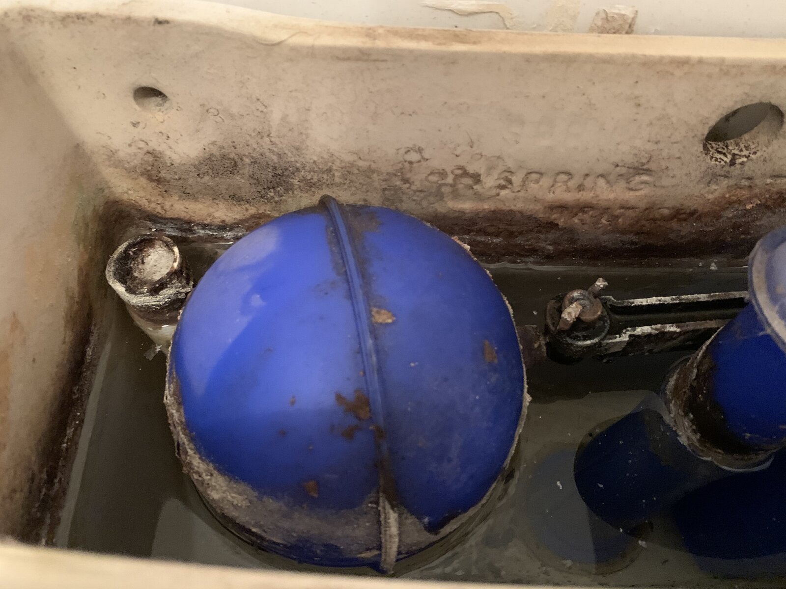

Pics of the worlds grimmest cistern, have circled what I believe the overflow pipe should be connected to?

No, circled red is part of syphon, overflow is the white standpipe, which should be connected externally or as a clamp to flush pipe.

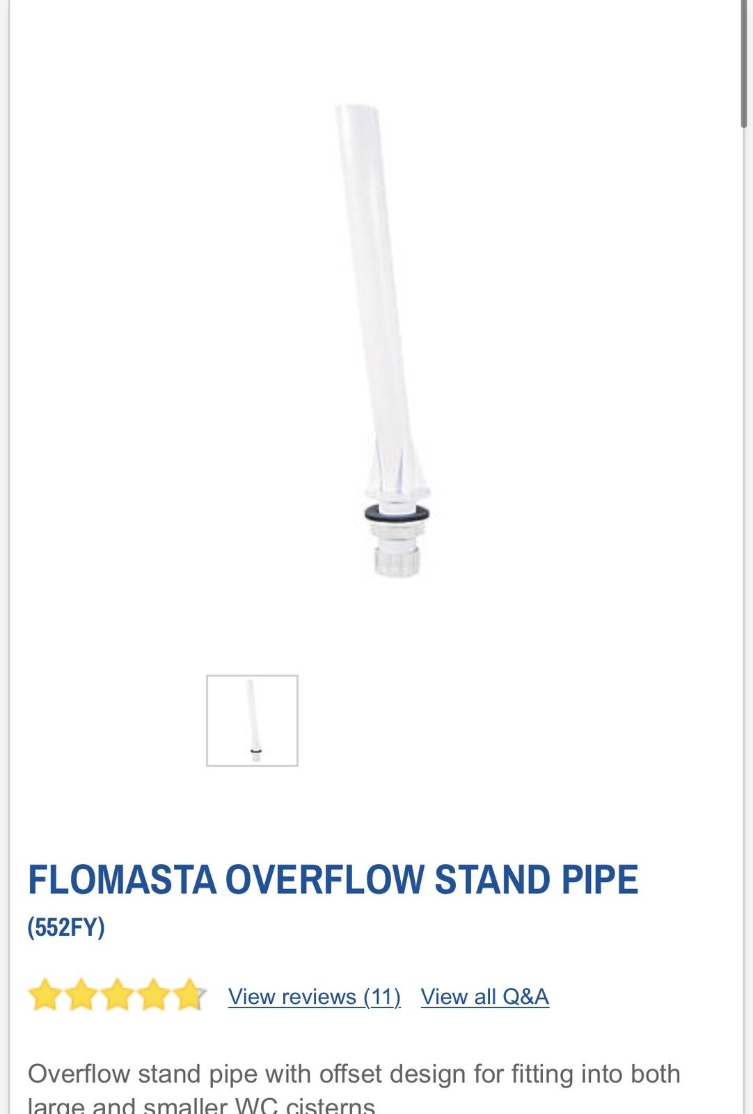

Thanks, so it’s a replacement standpipe that’s needed (pic in my first post from Screwfix).
At present it’s a standalone tube that means it overflows onto the bathroom floor - please could you tell me the name of the extra part I’d need to buy to connect it to something else and if it’s doable by a very clueless DIY-er or do I need to get my friendly plumber back?!
You either need to connect extra piping to that outlet and vent it externally or change the siphon in the cistern to one that includes an internal drain (so that it drains into toilet bowl). No offence but it sounds like you may need to get a plumber to do it for you.

The standpipe is already in the cistern, you need overflow pipe and fittings to outside. Or as I have suggested and Durham Plumber - fit a blanking plug and fit a syphon with overflow.
