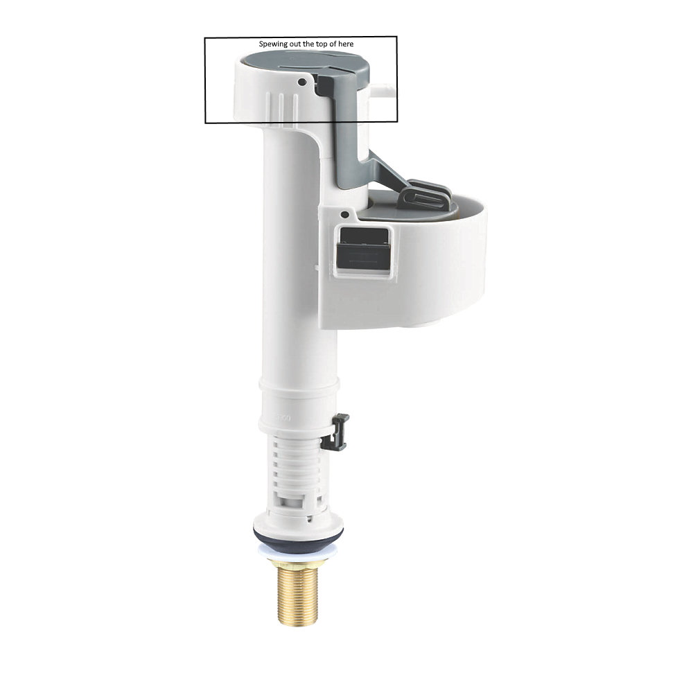

I'm not there at the mo but this is the unit in question. The water comes up through the top. It does whistle like its trying to stop but its obviously not sealing when the paddle rises to shut the water off.
When its taken apart there is a black washer inside.

When you have a faulty item, a photo of the faulty item will be very much more use than a photo of another item that is not faulty. Inside the cistern will also be a flush valve and some kind of overflow.
If you can see the supply pipe and its connection to the valves threaded stem ,you can change the float valve without removing the WC.
If you can't ,cut the silicone with a long very sharp knife ,or hacksaw blade ,behind the cistern. And Stanley knife around the pan / floor.
