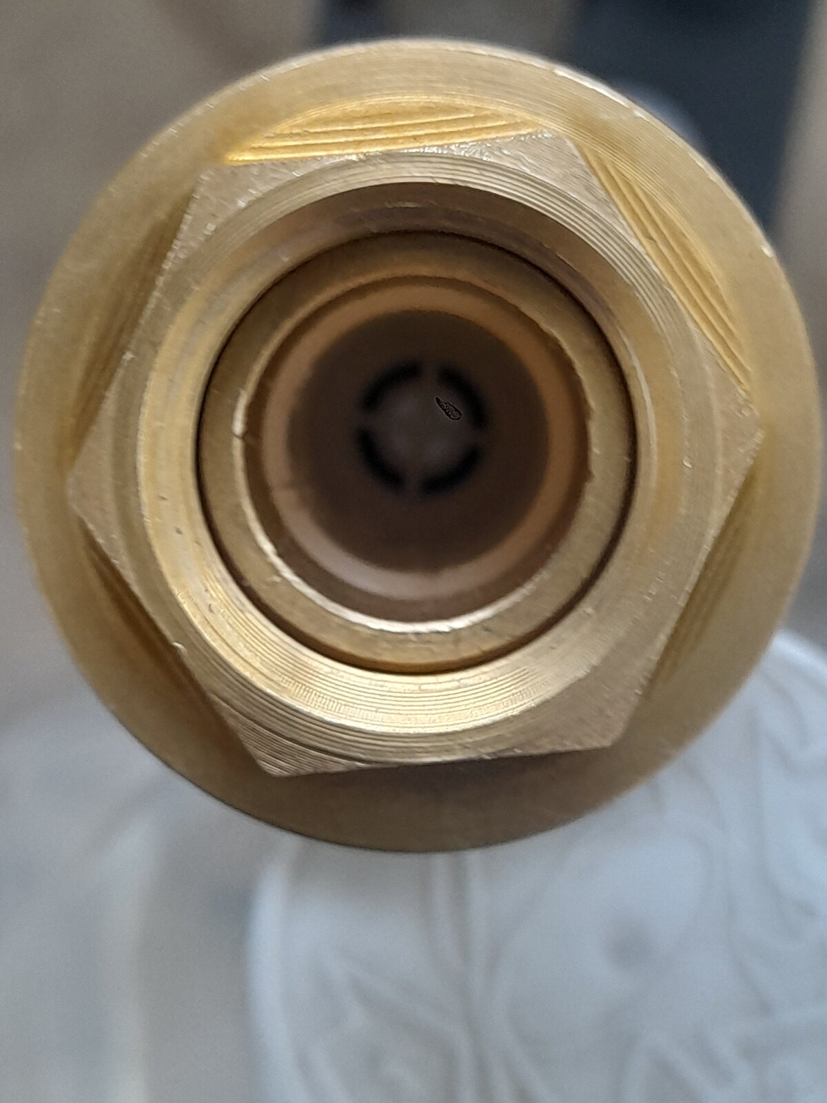

Hi, I just bought a filler valve from screwfix and the 'spout where the water should come out is blocked off by design. The cistern only fills up very slowly, seemingly seeping out of the top.

You mains water pressure or is cold water coming from tank so low pressure.
Some inlet valves have insert which is removed if gravity fed to allow water through faster.

Think it may be a case of low pressure. Yes, gravity fed. Took hose off filler valve and it seems low. Can I get a low pressure filler valve?
Hi again, first pic shows a filter which was easily removed but removal didn't seem to cause any increase in the flow. Third pic shows why possibly. There is some kind of plastic restrictor in the pipe leading to the valve. This wont budge. Maybe I could drill it out? What do you think?
Or maybe I'd be better off drilling this pin hole widening it to give a greater flow? Maybe the valve would stop working if I did?
Drilled pinhole.
Takes a while to fill up but not very noisy and the valve seems to shut off nicely.
Is there a low pressure option. I seem to remember there not being pinholes in previous fillervalves I've fitted. Indeed the one I took off had a much larger guage water feed.
Widening the pinhole seems to have been the solution. Takes a couple of mins to fill up to 6 ltrs but the valve shuts completely when full. Tried a few flush cycles and all seems fine.
