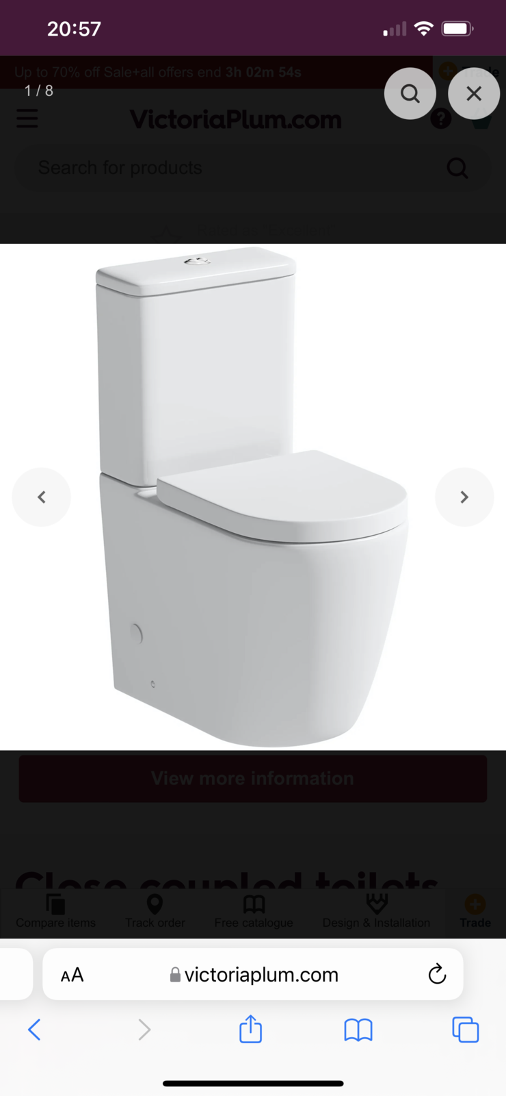

Hi there. I installed a new toilet not long ago. How come the flushing is not that strong? I have to hold the 2 buttons when flushing to get the maximum power. Even then the flush isn’t as strong as Id like it to be. My previous toilets flush use to be VERY STRONG!

Take your pick from
Design of toilet pan and cistern
Design of flush valve regarding releasing water
Level of water in cistern requires adjusting
Flush valve needs adjusting

When the Flushing Toilet was a relatively new concept, the Victorians designed them with a High Level Cistern, which, when flushed sent a tsunami into the pan and was devastatingly effective at clearing whatever was deposited. Then we tidied things up and went to Low Level cisterns, then tidied up a bit more and went to close coupled.
Then some bright spark had the idea of reducing the flush volume to 7 then 6 litres to save water. Only it doesn't as you need to flush the bleddy thing several times to clear the pan, which actually means you end up using 12-18 litres of water, up to twice what would have been used had the tried and tested concept of a 2 gallon flush been retained.....

What type of toilet is it? I once cut the flush pipe too long. It went too far into the bowl and limited the flush flow.
Otherwise as per suggestions above

Check you have maximised the water depth by adjusting the fill valve
I find the Flapper valve gives the most powerful flush for any particular pan, it is supremely simple.
But pan designs vary.
IME pans from the best UK makers are better than no-name imports and budget offerings.
I have been especially pleased with Twyfords although they are now owned by Geberit they are still making a lot of the existing designs, including E100 which flushes well even with low water volumes.

Its like this one here
