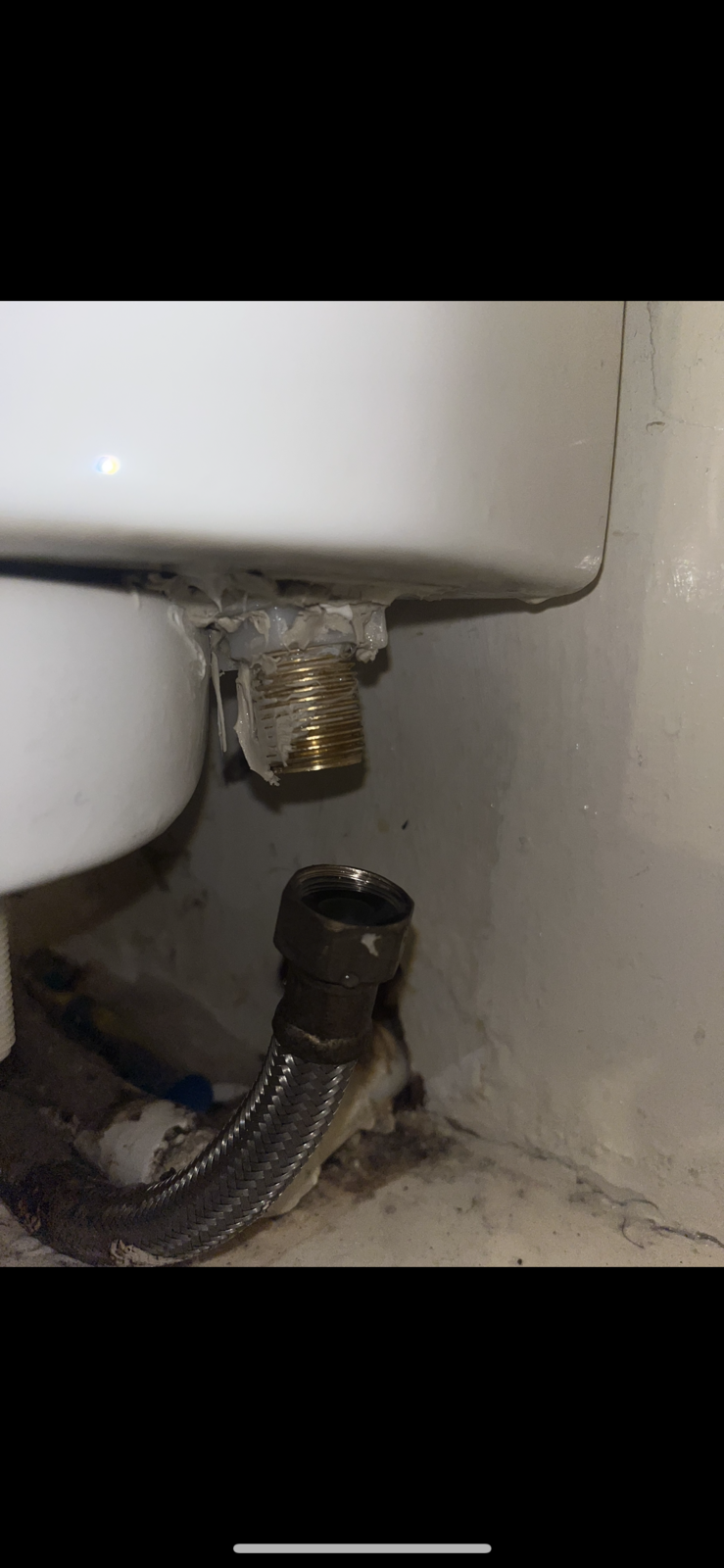

So I need some advice here. The old toilet fill valve was not working and underneath were the nut is was secured by silicone. Changed that and now I can see the angle of the nut is slightly angled. The nut can’t fully close and it just keeps leaking. Any way on sorting this issue out ?

The valve stem is cocked to one side, was there not a rubber cone washer for fitting inside the cistern.
Yes there was I fitted that inside. But it seeps through and the nut can’t fully go up.
That is because the stem is leaning over, suggest you remove all parts and silicone (which shouldnt be required underneath) and start again.

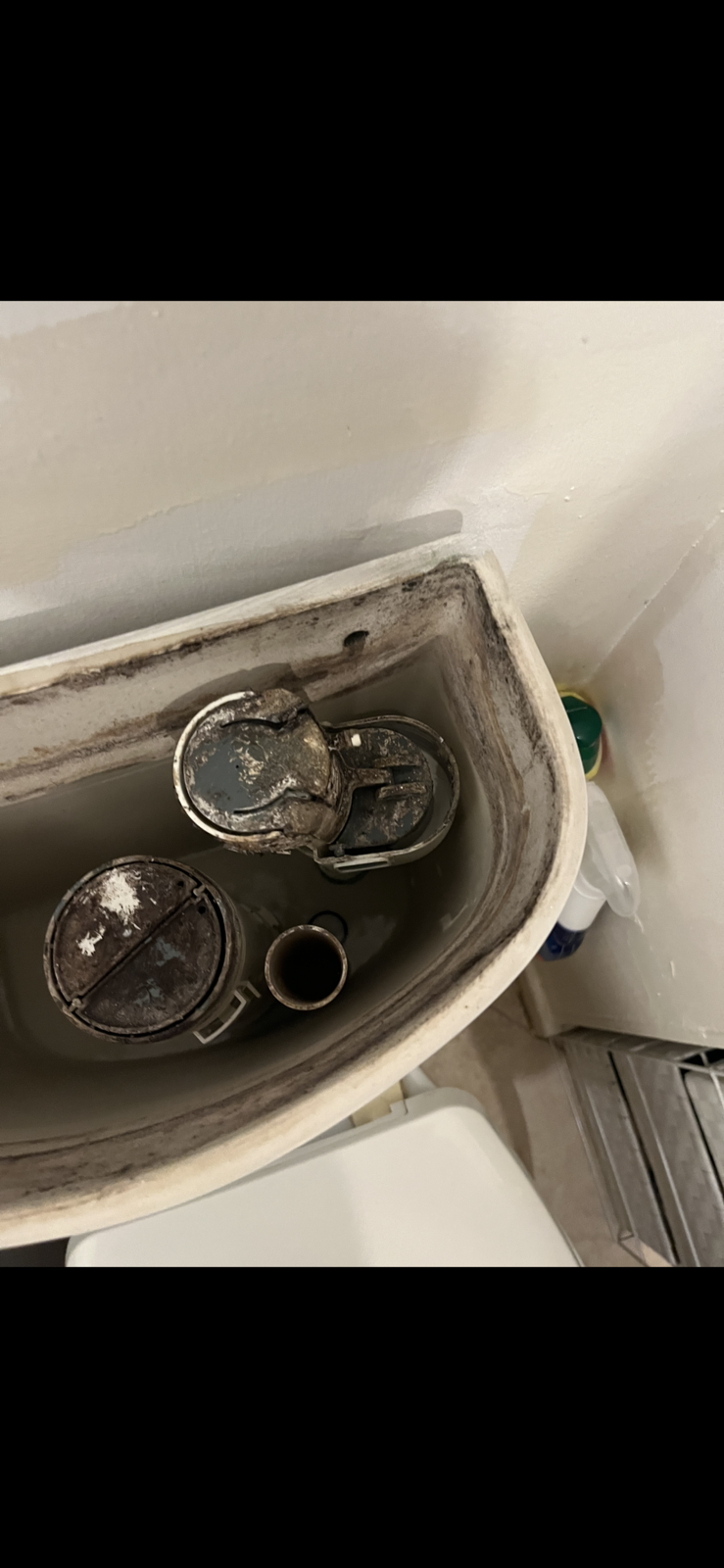

Show us a pic of the internal cone shaped washer and inside of cistern base ,and float valve. Something is preventing the float valve from sitting upright ,you may have the wrong type.

The problem is it don’t fit straight. Because of the toilet. Probably why they used silicone before

This was the previous one I replaced

Looks like it's the wrong type ,and is binding on the cistern wall.
What's your new one like ? If it's the same as the pic ,it's the same issue !

If that doesn't fit your cistern must be a very tapered shape. Is it wide at the top ,and much narrower at the base . Sounds like you need a very basic ,slimline , fill valve.

I’m just confused as the other one was at an angle too but was not leaking. But it was covered in silicone at the bottom. I took all the silicone out to put the new one in. It has a cone shaped washer and I placed that correctly in the cistern
What are you confused about ? It didn't sit square and was bodged with a load of silicone. Float valves do not need any silicone whatsoever to seal To a cistern.
Is the new float touching the cistern at all? If it is, angle it away. Also scrape off that silicone and plumbers mait (putty).
