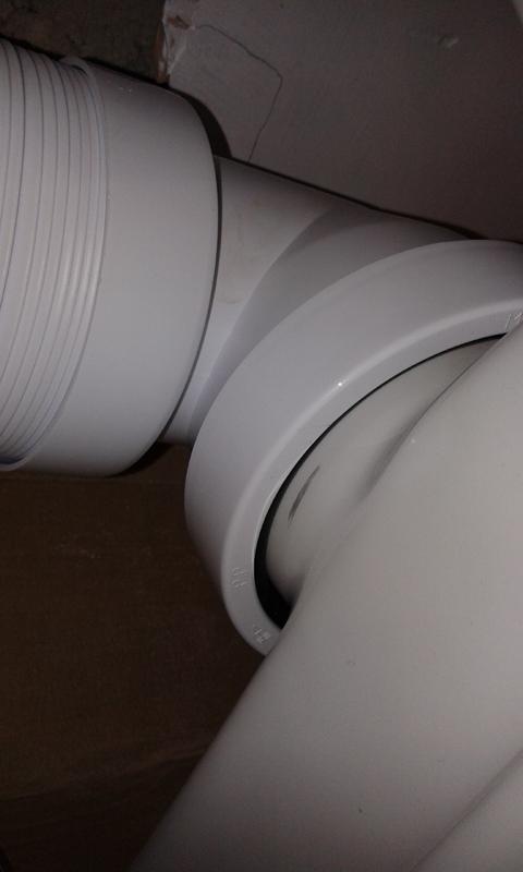

I've just fixed toilet in place and attempted to connect the 90 degree connector to the soil stack (which is right in the corner of the room) and the connector falls short (Roughly 1 or 2 inches). I have attempted to force the connector at a odd angle but the seal doesn't look great and pops off.

I twisted the stack connection roughly 10 degrees, A little pull and some fairy helped it move. I connected the flexy and took what ever bend could be made for the short distance and moved the toilet slightly to the right.
The seal seems in tack, so this is my option at the moment but i'd soon use non flexible connecter as I've read some people don't like them.

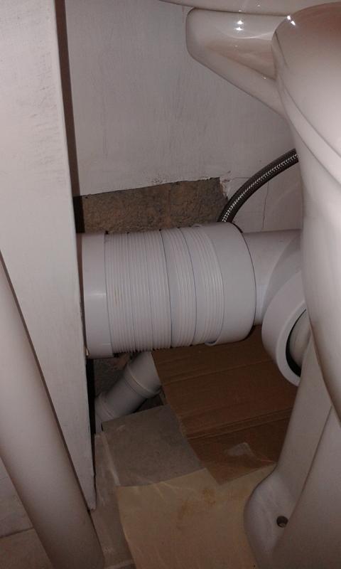

I haven't got any pictures of the connector being a little short but I do have some of the current setup which may (with the diagram) help show the angles i'm working with.
Shows the soil stack twisted to accommodate flexy. Plus show good seal to pan.

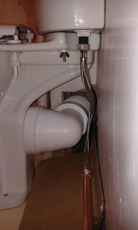

The tile is not yet on the back wall, which means it'll be pushed out only further.
Second image shows the seal on the left side (Pencil mark is three quarters from the end, so more than half is sealed. However when the tile is on the back wall I expect this to decrease.

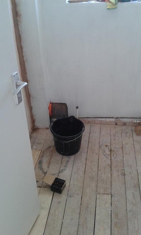

Third image is general view, hopefully showing soil twist angle (roughly 10 degrees) to make the flexi a viable option. Due to the tight fit, there isn't a great deal of flex in the flex.

In your last pic the floor (at the wall) appears to be dropping from left to right - maybe its the camera angle or a sloping pipeline?
Given that your pan is not in its final position until the wall and floor are tiled, then you could leave the present arrangement as it is - there's plenty of play in it - and wait and see?
Dont fix the WC to the floor or wall yet, maybe a few dabs of silicone to hold it to the tile for a few weeks.
If it leaks then go for the best, but more expensive, option given above.
Thanks guys.
The toilet is staying with the current configuration until the tiling is done.
Then I'm hoping to twist the soil back (hopefully no 20 year old creaking sounds this time) and try the non-flexy approach first.
