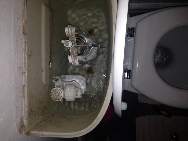

Please help for some reasons I'm doing something wrong, the toilet is overflowing into the tube as the water is not shutting off. I have replaced the washer in the injet valve but it's still not shutting down, when I manually raise the ball the water still doesn't shut down, water still splashes out from the lever unit unto the walls of the toilet bowl does this mean the washer isn't working? I have tried lowering the float ball but still no difference please someone help much appreciated

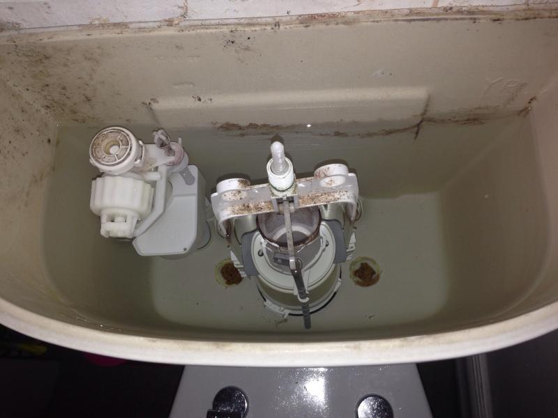

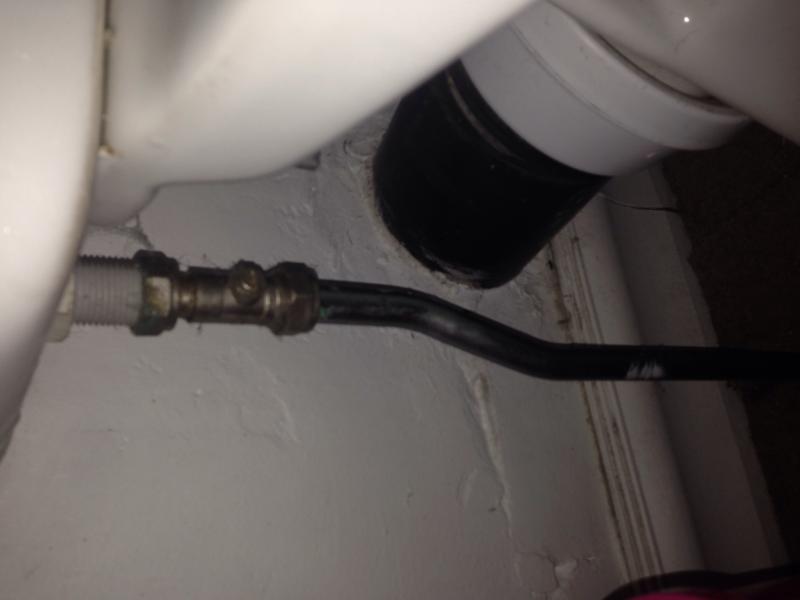

Here are the pics. I followed all instructions carefully but to no avail. Do you mean I should buy a new washer or a complete injet system ? Incoming water pipe is at the bottom, and I don't think there is a tank at the loft
Just buy a new bottom-entry fluidmaster, it should be an easy swap for your old one. I don't know how to service the old one.
turn off the water supply at that flexible braided hose (turn the screw-head so the slot is at right angles to the pipe)
