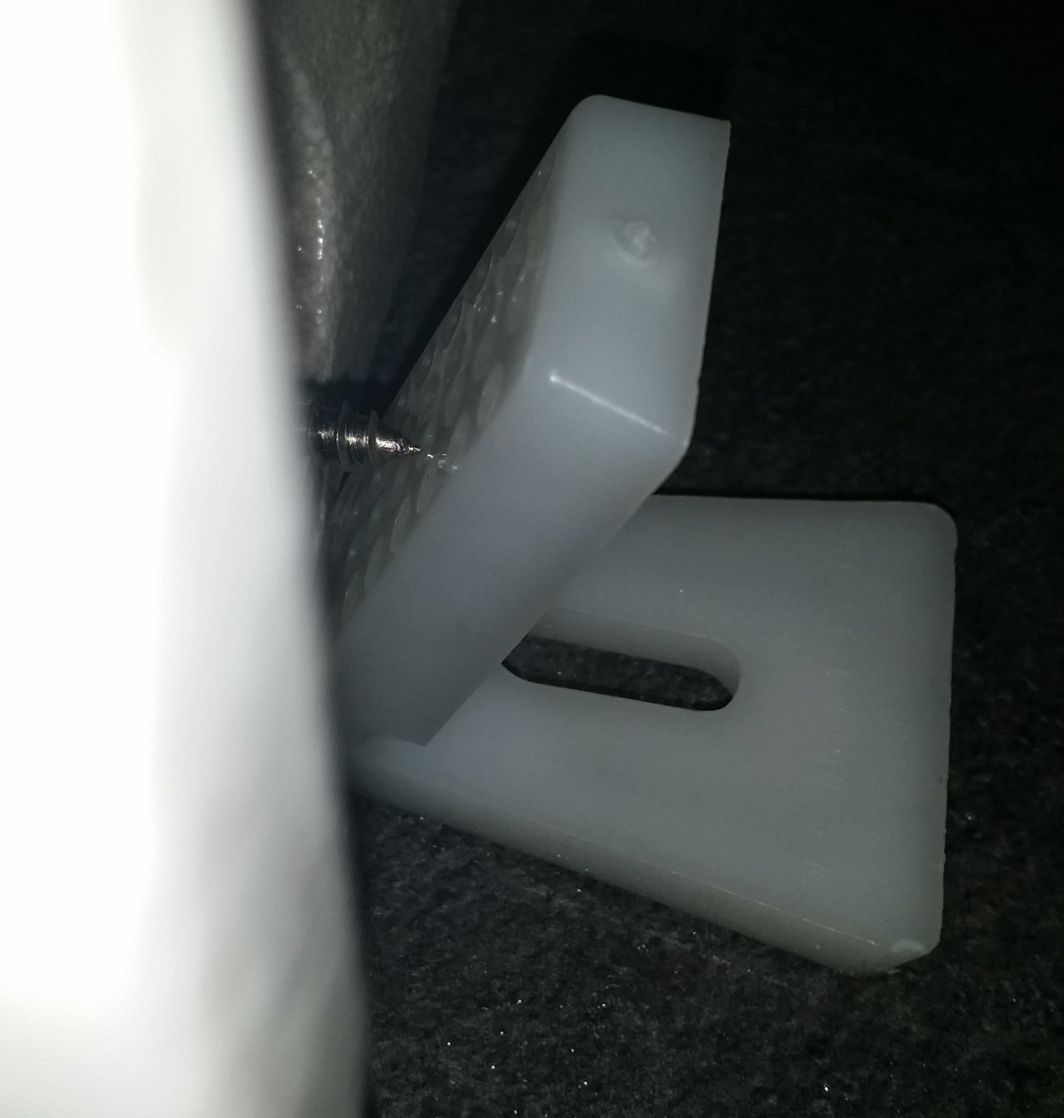

I bought a back to the wall toilet about a year ago and have now decided to install it!
I have tried the floor fittings (can't remember if I purchased them separately or came with the pan itself) but because the brackets are angled, the screw doesn't reach the bracket.
These brackets are standard so I'm wondering if my pan is different where the brackets need to be at a 90 degree angle instead.
Are they supposed to bend significantly?
Hope that makes sense.
they do bend.they should be spaced apart ,left to right , so they are touching the inside walls of the WC pan..you either have them in the wrong positions ,or have the wrong screws .

With the bracket flat on the floor, I'd say the part of the bracket that's supposed to touch the pan bends about 40 degrees away instead.
If they're supposed to bend that much away from the pan then fine, I'll have to buy longer screws to reach the brackets.

they do snap actually , so I warm them up a bit. you are right they are at an angle , away from the pan ,but they do work by applying a downward force when screwing them up. you MUST have the plastic bush in place ( what the screw goes thru and fits in the hole of the pan ) ,or you may crack the pan.
They are meant to be angled, they are a universal fitting and many pans have different internal structures. It allows for a little play when putting the pan down once they are screwed to the floor. The side screws should easily be long enough to catch one of the holes if your measurements and placing is correct.

The pan is supposed to be fixed that way, I can't see how it would be secured any other way. The screws are about 55mm long but if I get 70mm ones then that should reach. I just hope the brackets won't snap when they get pulled all the way back to the pan whilst screwing them!

Well this is it with the screws that came with. They don't reach and I couldn't put my hand round the back to press it towards the screw either. I've used longer ones.
The trouble is, I've really had to screw them right up to the pan and yet the pan isn't 'completely' secure. I can still lift it slightly with a bit of persuasion. Is that normal?

Did you use the m6 bolts and plugs (if needed) to lock the bracket to the floor, couple of washers too? You need longer screws to go through the side of the pan and you should have to tighten them 'just enough'. If the brackets are tight to the floor and the toilet's base cast is square to the floor then there should be little/no movement. If the pan isn't tight to the floor and rocks a little then silicone will probably be needed.

It's secured to the floor using wood screws since the flooring are vinyl planks and underneath are floorboards. I can see that the part of the brackets stuck to floor not moving at all but the angle part of the bracket seems to be lif up slightly with a fair bit of pressure. The more I tightened the screw on the pan, the less movement there is but the brackets now seem to be at a 100 degree angle - hope they won't snap.
I guess it's good enough but it just seems to have not done what it's supposed to. I really don't want to put any silicone down as it looks really nice without it and the floor is watertight anyway. I'll see how it goes!
