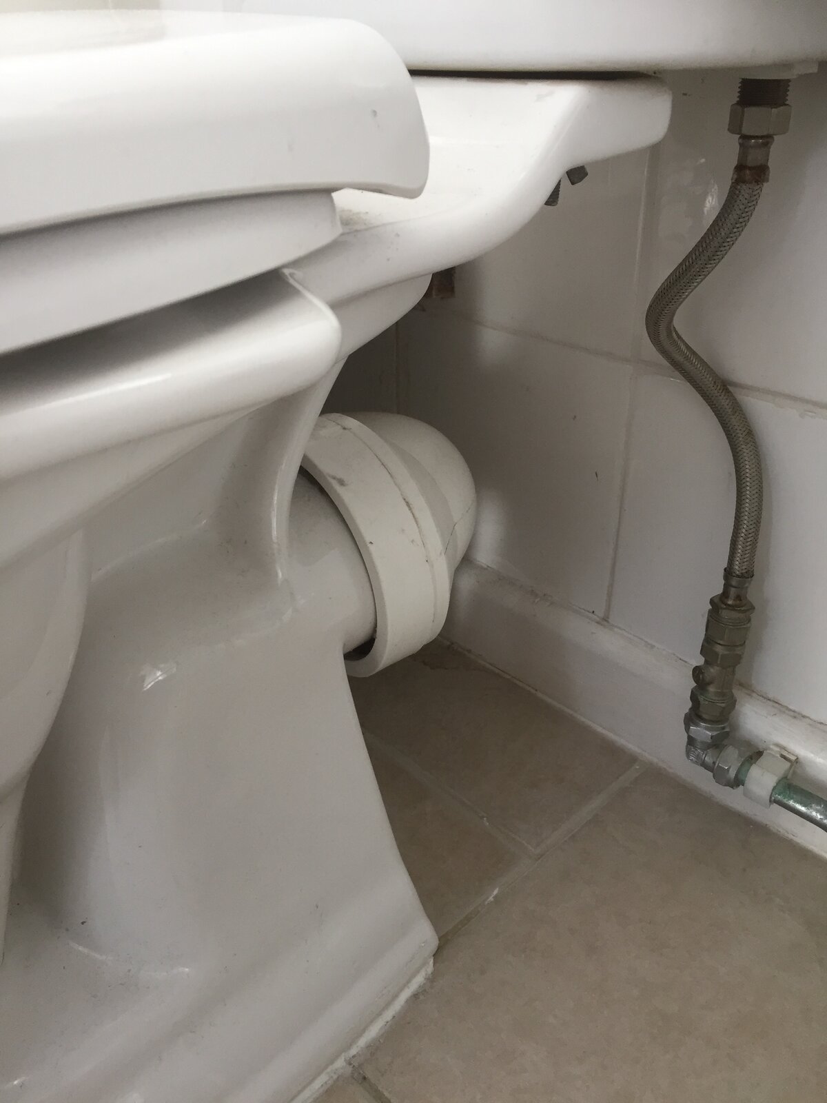

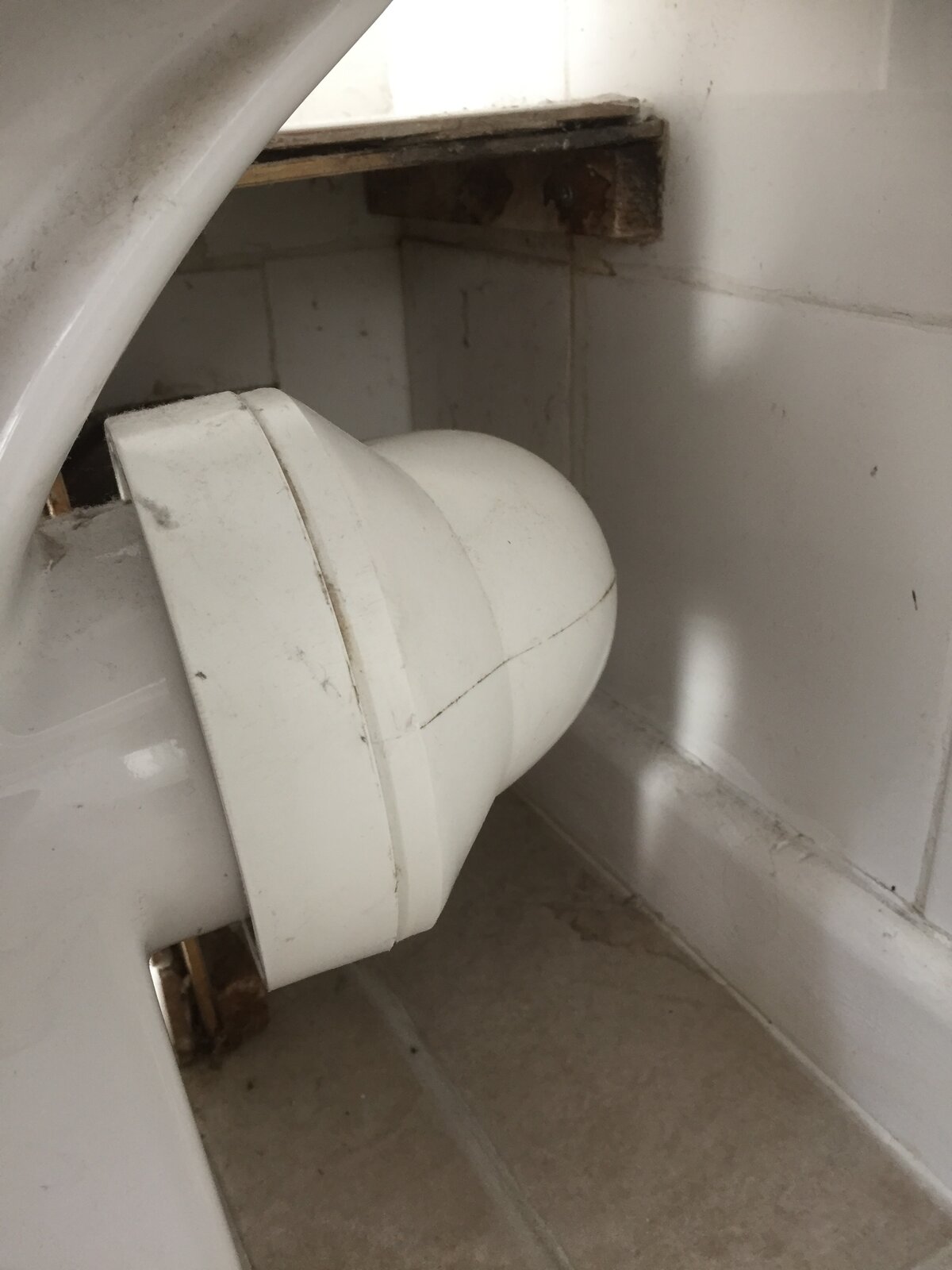

Hi, I’m thinking of upgrading my toilet from a traditional style to modern.
The soil pipe from the wc exits on the left and the spigot is 180mm from the wall. The pan base is 220mm from the wall.
Can anyone please tell me where I can find a replacement to fit these measurements?
Photos attached
Regards Dave

You need to be measuring the floor to centre of the soil connection, and then when you have found a toilet you want, have a look at the technical drawing.
