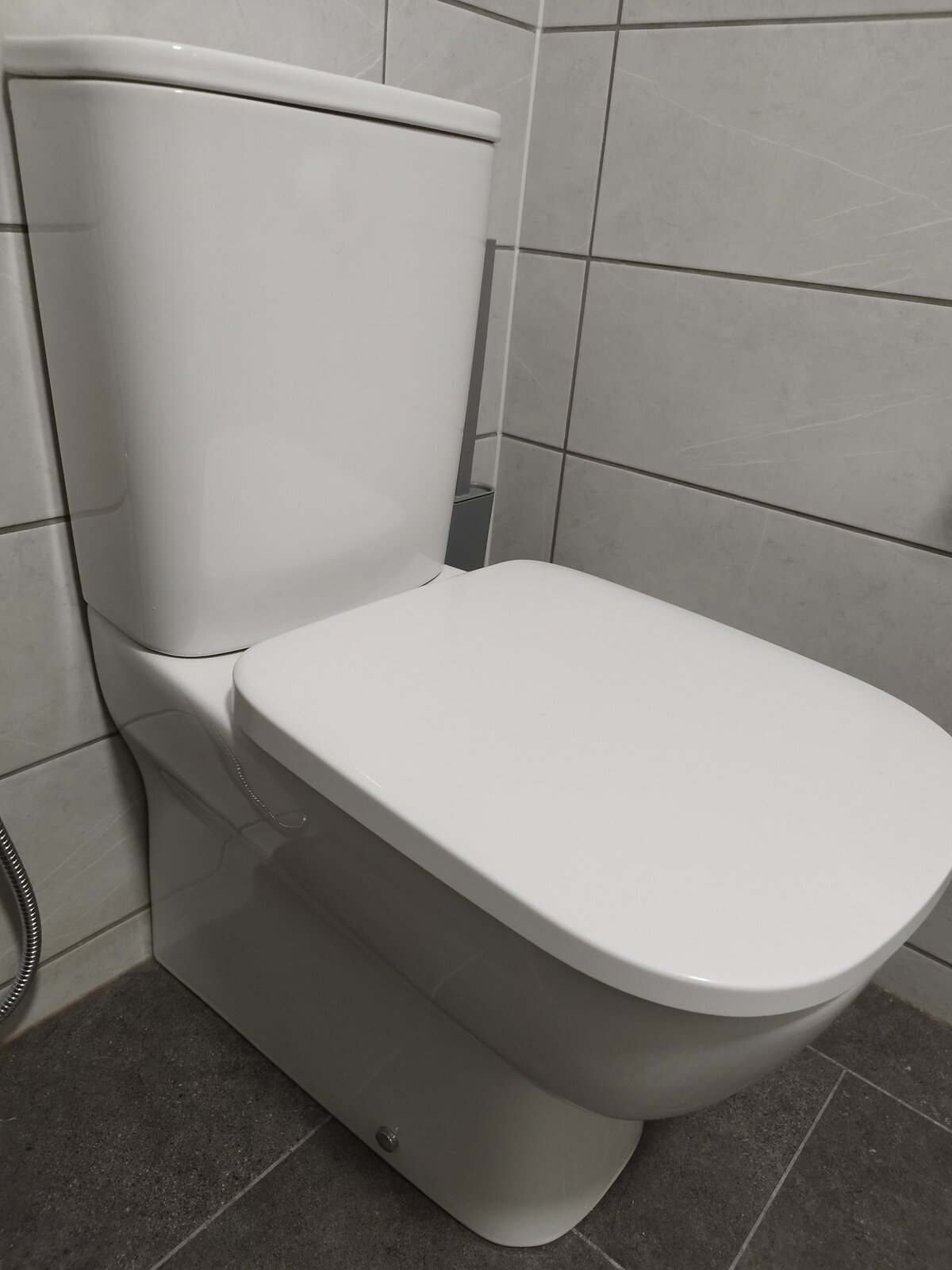

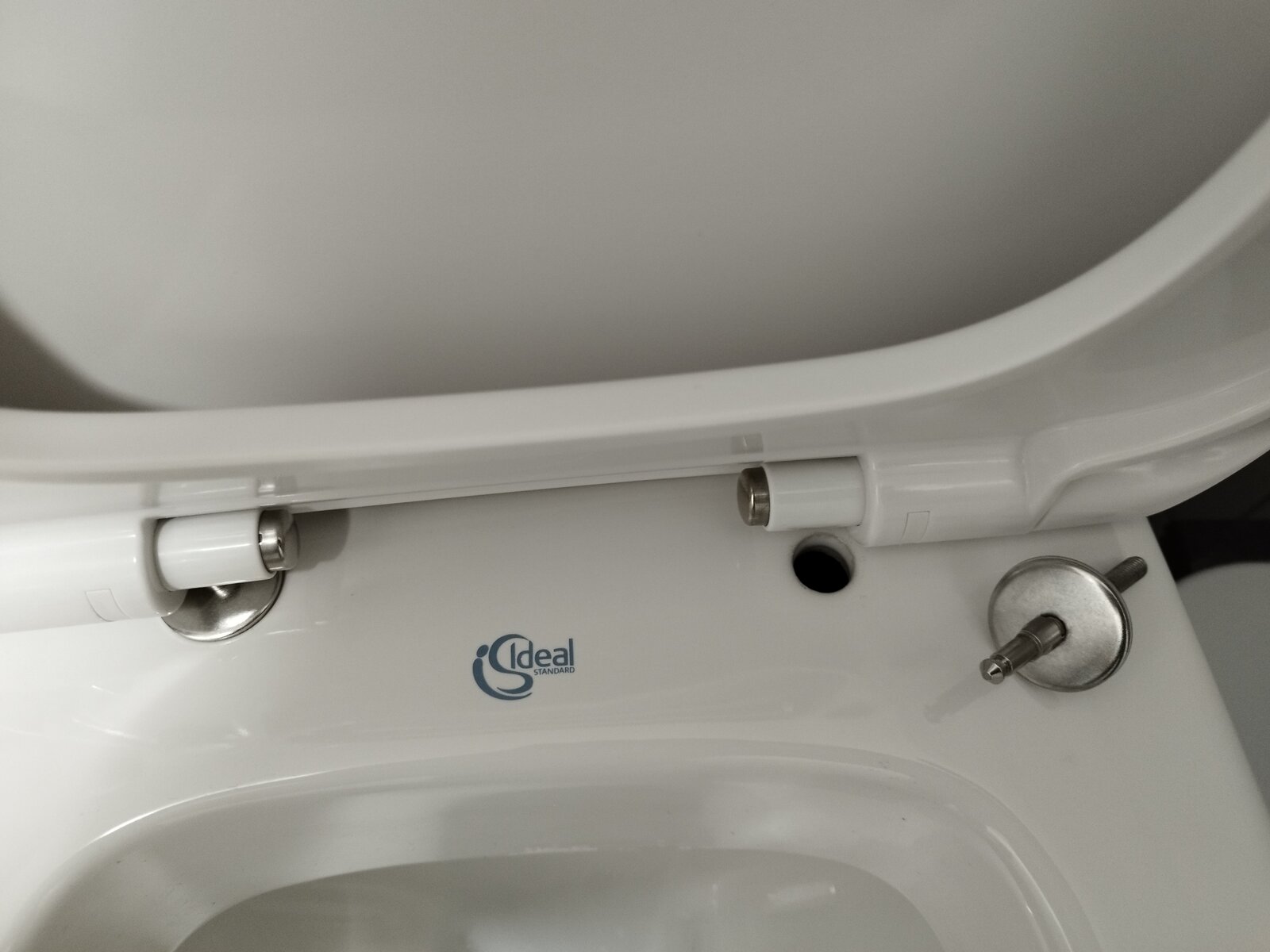

Hi,
The toilet seat was loose, so I decided to cleverly unscrew the mini rod, and to my horror the fixing on the otherside of the hole underneath, feel straight to the floor. I cannot access this now as the hole is too small. Please see photos. It's a back to wall toilet. Is it an easy job to disconnect this toilet and to retrieve the fixture part from the floor? I'm afraid of all things plumbing, but was wondering whether a monkey could do this, if so what steps are involved?
I've also seen an extendable magnet rod on amazon which can literally lift hammers, is it as simple as buying this tool? Will the fixing fit back through the hole?
Thanks in advance.

Thanks for the responses everyone, it was all taken on board. But I really wanted a like for like replacement on the hinges. This seemed like the most logical (and cheapest) way to go. In the end, I did source this from ideal standard's spares website.
It was a soft close hinge pack for my particular toilet model that I needed:
This took less than 2 minutes to install, without needing to remove the toilet or any nonsense like that. All for under £7!
Whilst I appreciate getting a new toilet seat is a valid option, this really seemed like a nuclear option which would also mean selling/getting rid of my perfectly fine working seat. This simply does not make sense, I would not be recommending this for others in the same situation as the first go to solution.
I hope this helps anyone else with a simliar problem.
Good find!
For future reference, I'm sure you now know that the seat can be unclipped and removed by pressing the 2 chrome buttons next to the hinges.
So if it comes loose again, don't unscrew anything, but remove the seat and tighten the hinges.

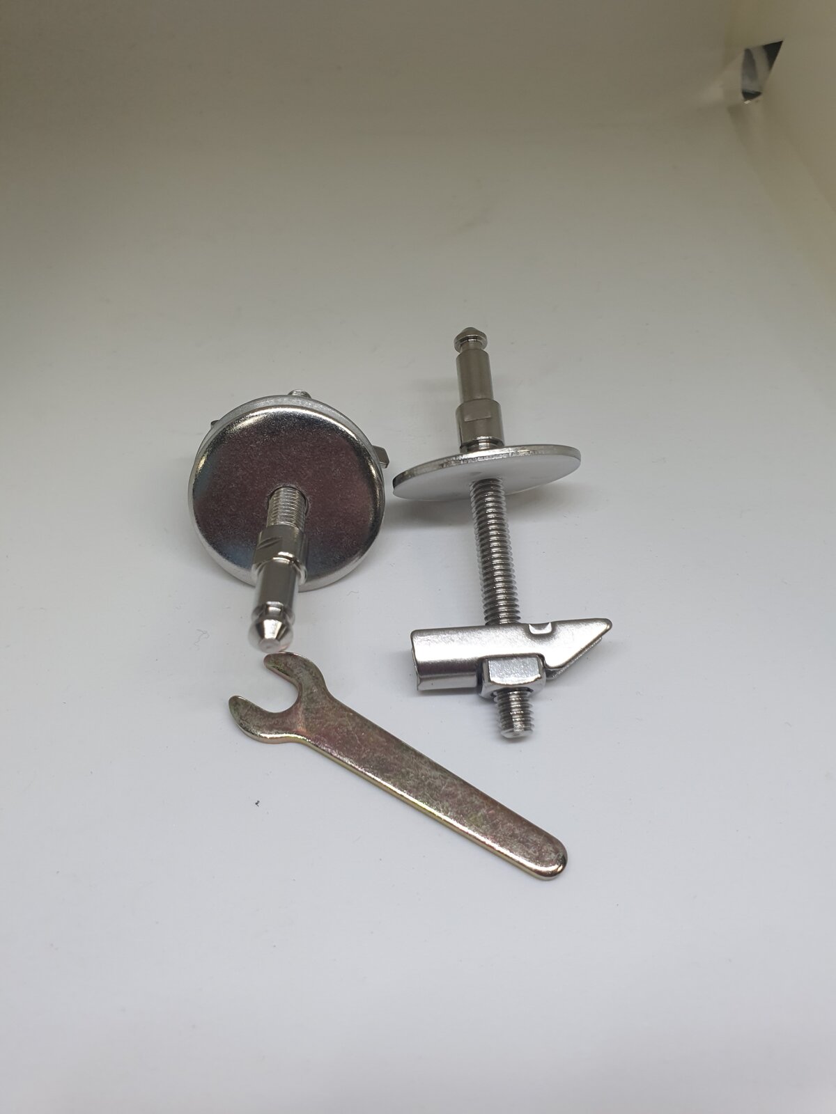

These are the type of "toggle" fittings that I am referring to
haro_c0102g_softclose_classic_hinge_bvo_-_toggle_bolts_stainless_steel_1_set_407559.jpg
If you try to remove the fitting, the lower part falls in to the cavity. The above costs £38.99. I don't know any local plumbers' merchants that stock them.
Would you be happy if a plumber told you that you would have to wait 3 days for delivery before you can use the loo seat again, and that there would be an additional charge for them to come back.
As per @Madrab 's post whenever it is possible I fit a new blindhole/topdown fitting. In the example above though the threaded rod is part of the fitting and not a separate machine screw.
