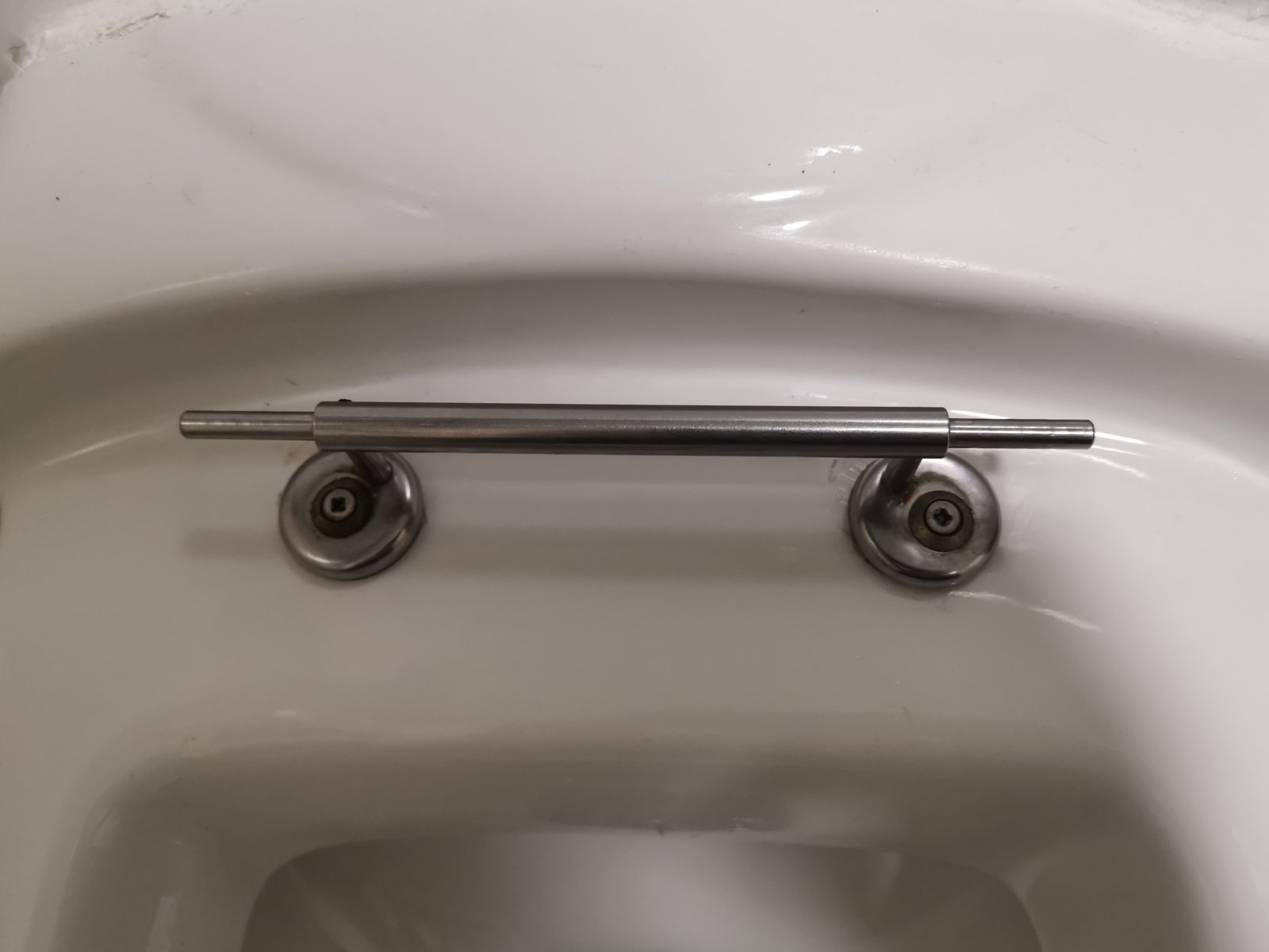

Hi

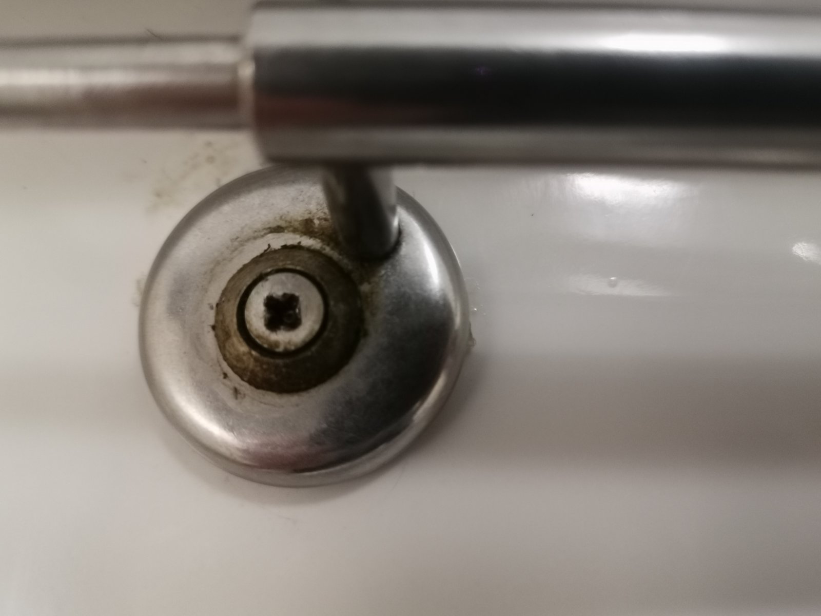

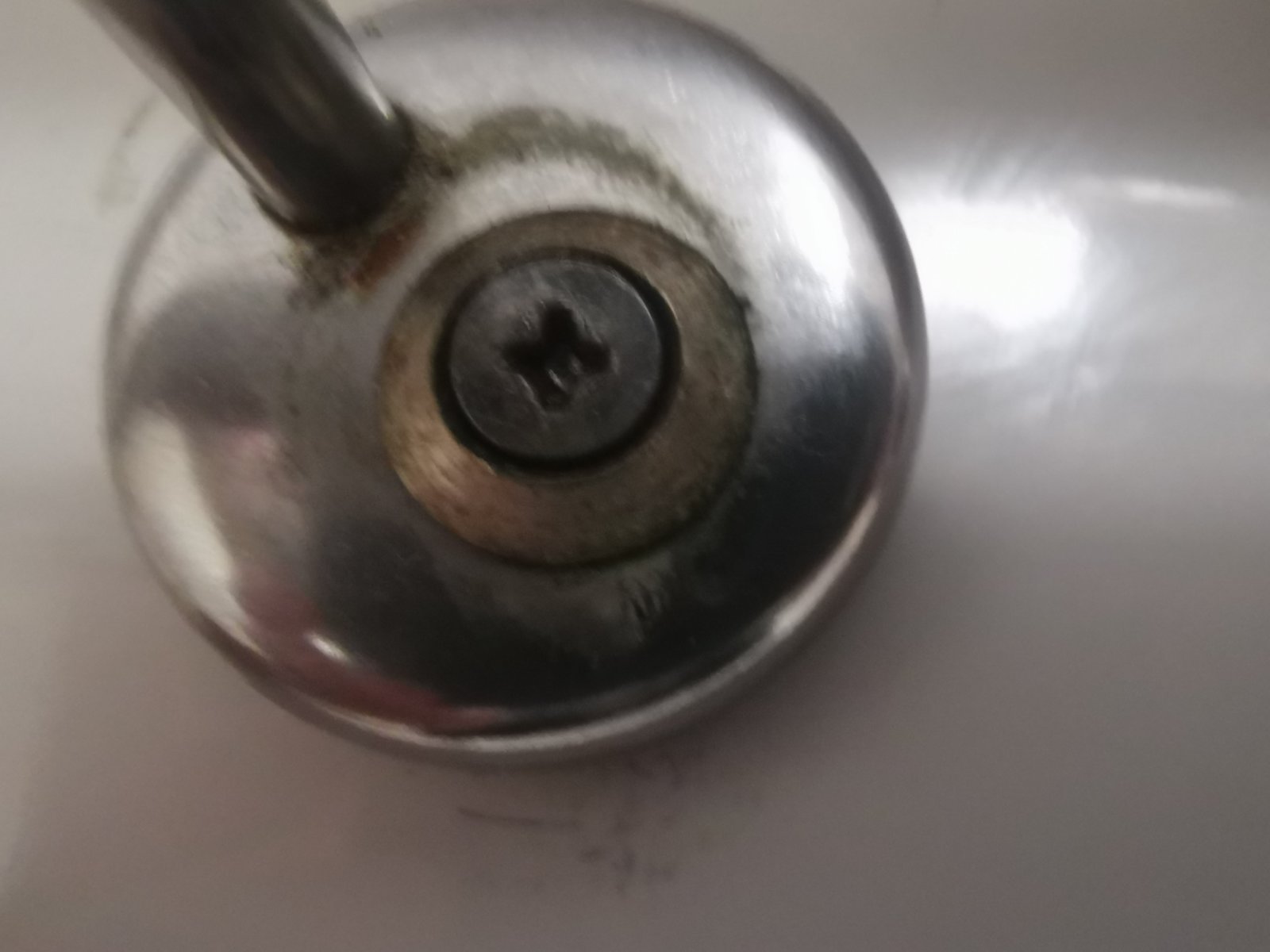

Our toilet seat is super wobbly. Everytime I tighten up the screws it lasts maybe a day before it becomes wobbly again. I've tried to replace the seat tonight but only got this far as I can't get the actual bar bit off. I'm turning the screws but nothing seems to be happening. It's a wall mount toilet and there are no visible fixings so no nuts for me to try and loosen etc. Not helped by how old it all is and how badly damaged the actual screw head is!
There are a number of different fixings but you could reach under neath and see if you can hold them whilst unscrewing from the top.
Looking at the state of the screw head it may be worth asking someone else to unscrew them whilst you get more involved.
Otherwise can you pull upwards on the bar as you unscrew it?
I had a similar situation which involved me having to break the chrome caps to get proper access as everything was so corroded.

If you pull upward on the horizontal bar ,whilst turning the screw anti clockwise to unscrew ,the screw should remove completely. You will then be left with the expansion anchor left in the WC pan ,or there will be a toggle on the end of the screw.
I came across one where the bolt went into a butterfly spring toggle type securing wing and another longer spring held the two together for retrieval.
I don't know if that is what you have, but if it is you need to maintain an upward pull on the bolt until it is released. I also suspect that it would be very corroded. Perhaps try some WD40??
